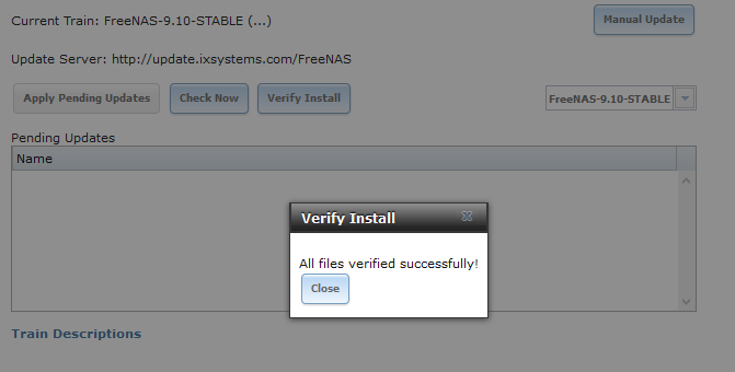

I'd be interested in knowing what the resolution to this is. Have you verified your install? Should be somewhere in the System->update part of the GUI.

I've done the verification scan and the UI claims it's the files were verified successfully. (again attached to the main post)
Oh I'm sorry, I missed that you already did that.
