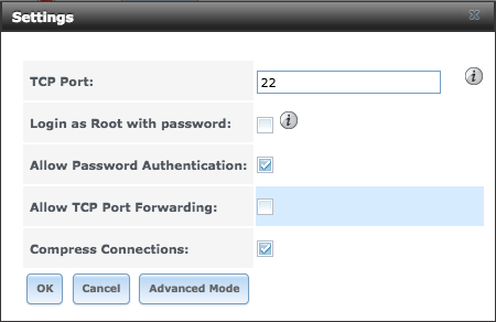

15,504
There's a FreeNAS setting for this:
I'm not aware of any practical way to change that at the command line without using the API.
