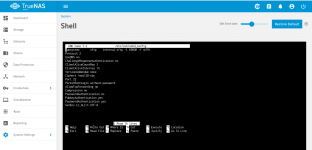

I attached some screenshots showing this problem.

I searched the whole file system for important sshd_config file for configuring SSH
Don't. TrueNAS is intended to be configured through the GUI
But I was wondering if I could also log into OpenSSH server in TrueNAS SCALE when using it in LAN just by providing username and their password which was set on this TrueNAS server.
You can, but why would you want to? Public-key auth is both faster and more secure. But there's no reason to be manually entering aux parameters for the SSH setup in order to allow this; just configure the service like this:

You may also need to enable SSH password login for "kevin" under user credentials.

Ok, my problem with this connection via SSH using passwords is now solved.
I needed to enable SSH password login in the settings of kevin user, as tprelog suggested.
