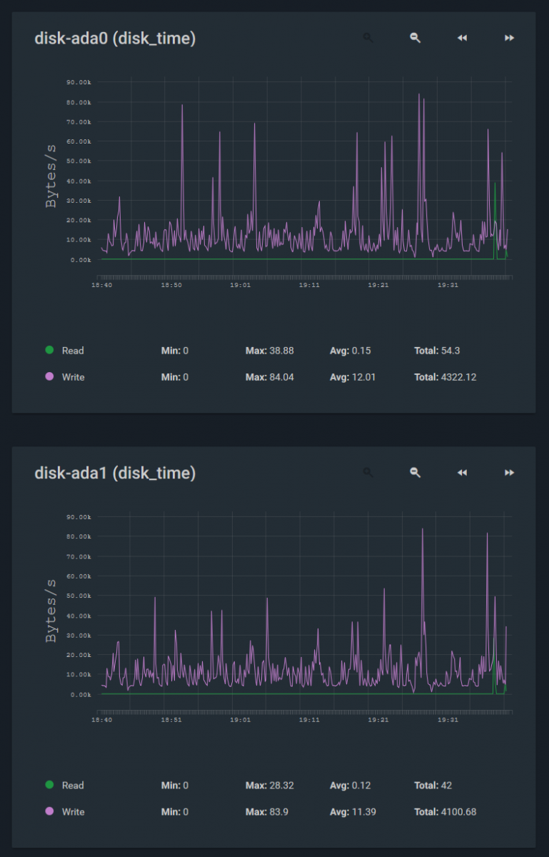

Sacred? Really? It is easy to move the system dataset somewhere else. Recommend NOT using USB boot media because they tend to fail relatively quickly. We used to suggest that YEARS ago but for a long time now we have been suggesting a SMALL (low capacity) old SSD. A 20GB model will be bigger than you need, but I am using a 40GB model because it was the smallest I could buy at the time. With the endurance of an SSD, you can put the system dataset on the boot pool. With the system dataset on the boot pool, the activity on the boot pool will look like this:
That amount of activity will kill a USB memory stick quickly (couple months) but a SSD handles it without any trouble.
