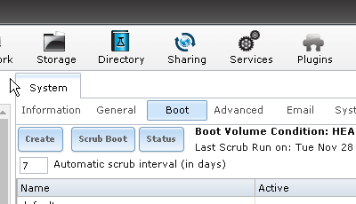

The scrubs are not on my main volumes they are set to monthly. The scrubs relate to my Freenas-boot volumes even though the automatic scrub value is 7 days which if i understand correctly a scrub checks for errors.
So even though its set to 7 days see below does anyone know why its happening daily?
Mar 9, 2015
11
Just an update, I changed the 7 day automatic boot scrub to 14 on all free as instances and now the daily boot scrub has now stopped and happens fortnightly.
Since this is now correctly happening on all four I can only assume this is an issue with the scheduling.
That now works as expected and will wait for upgrade to reduce the emails
Something must have been interrupting the scrub, so it didn't finish. That made the system think it still needed to do a scrub the next day. It is an unusual error. You might want to open a ticket on it so they can review the code.

No. Once a week is reasonable for the boot pool.
When he had it set to 7 days it was scrubbing everyday
Yeah, well, that's not what it's supposed to do and indicates that something is very wrong, probably with your boot pool. Start by looking at zpool status to see the scrub stats.

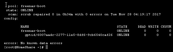

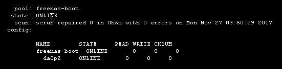

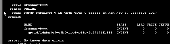

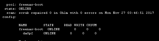

All four Freenas machines report 0 errors corrected in XXX with 0 Errors using zpool status
Will leave at 14 days and keep checking in to see what is happening
Cheers for your input

The output of zpool status should look something like this:
  pool: freenas-boot
 state: ONLINE
  scan: scrub repaired 0 in 0h11m with 0 errors on Sat Nov 25 03:56:35 2017
config:
   NAME											STATE	 READ WRITE CKSUM
   freenas-boot									ONLINE	   0	 0	 0
	 mirror-0									  ONLINE	   0	 0	 0
	   gptid/f659fd6d-4b12-11e6-a97c-002590aecc79  ONLINE	   0	 0	 0
	   gptid/f6a61d33-4b12-11e6-a97c-002590aecc79  ONLINE	   0	 0	 0
errors: No known data errors
Would you share that with us?
Mar 9, 2015
11
Just noticed the last two i have cut off the final line but it just reads the same as the first two "errors: No Known data errors"
Chris Moore
May 2, 2015
10,080
They look good to me, but you are using a single disk instead of a mirrored pair. Those Sandisk units are pretty decent.
