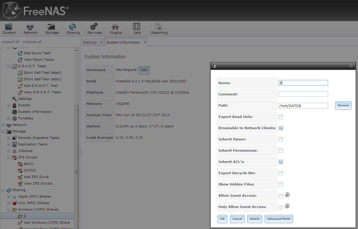

camilo suarez
Feb 28, 2014
86
its already unchecked :( heres a screenshot of the config

cyberjock
Inactive Account
Mar 25, 2012
19,525
I knew that was going to be your screenshot.
There's no answer for your question. The reason why is that there's so many factors that play into the behavior of shares that it's something you have to *understand* and apply for your server. How your CIFS settings are set up, how your server's file permissions are set up, what account(s) your desktop(especially Windows) has cached, and how your shares are setup are extremely important. Making it work how you want takes coordinating those 4 things(at least.. there's probably more but I just woke up) and it's not something that is easy to just throw an answer out there and have it be the correct one.
I will tell you that *mine* do exactly what you are asking to do, unless the user account I'm logged in has proper permissions in which case it authenticates on its own and "just works".

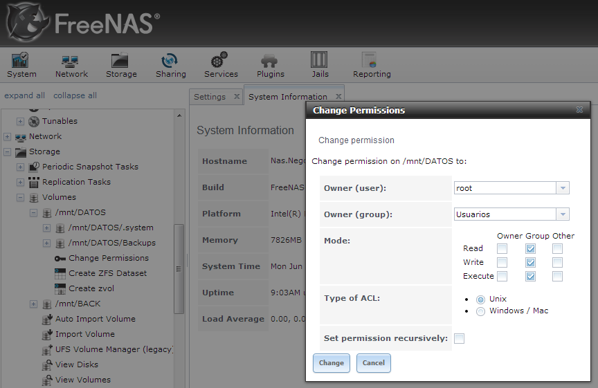

camilo suarez
Feb 28, 2014
86
Here are the Volume permissions; the "usuarios" group is the group that i created with the users that i want to have access to the files. What other screenshot do you need? to know what i haven’t set up properly. thanks for your help

anodos
Sambassador
Mar 6, 2014
9,553
A few quick pointers on this matter:
1) You're sharing your entire zvol (/mnt/DATOS). Don't do that (you will most likely end up breaking your CIFS config). Create a dataset to be shared.
2) Your permissions are wrong (in the big picture you want your user and group permissions under CIFs to be, well, permissive. CIFs has other ways of handling access controls.).
After you create a dataset, change permissions and set it to "Windows/MAC". Permissions will be grayed-out once you have done that.
3) Once you have created the dataset and set it's permissions, follow the steps here to create your share(s).
4) Once you verify that you can access the shares, use Windows Explorer (file manager) to navigate to your FreeNAS (i.e. \\ServerName). Right-click on your share, click on "properties", thence click on the "Security Tab". Then configure ACLs for your share. See this article for an explanation of Windows permissions.
CIFs is complicated and FreeNAS is complicated. Be prepared to read lots of materials. I recommend starting here: http://doc.freenas.org/index.php/Quick_Start_Guide and then proceeding on to reading the whole manual. Several times.
