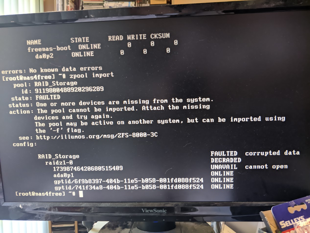

I have the failed drive disconnected from the system, have left the full health and degraded drive in there and also plugged in the drive that has an old data set that I don't know how long it has been uplugged so now have 3/4 drives in there. As expected it has now come up as a fault since one of the drives has old data it would be inconsistent and "corrupt", what's the command to resync this?
15,456
There is no command to resync this; unless you can bring the dead disk back to life, the pool is toast. RAIDZ1 can tolerate the loss of one disk without data loss. You've been running the pool with one disk disconnected, so there's been no redundancy. When the second disk failed, it was all over.
9,702
What I see there on the screenshot is that your server is called Nas4Free...
If that's the case, maybe you'll be able to get more help on the Xigmanas forums (Nas4Free was a fork from FreeNAS a long time ago and it eventually renamed to Xigmanas).

When the system was first installed it was running nas4free but that stopped working at one point so I reinstalled it with FreeNAS and imported the zpool, just kept the server name the same for his windows shares to keep working.
