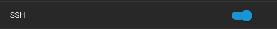

I just checked the box in TrueNAS-SCALE to activate SSH.
Port 22 SSH access is being denied.
Do I need to reboot the server for SSH access to be permitted?

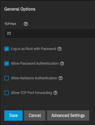

No, it should be effective immediately. Have you enabled root login (using passwords, if appropriate)?

Ha! I toggled on the Start Automatically and didn't even notice I had to also toggle on SSH manually - I'd have coded Start Automatically to check and automatically turn on SSH - saving the user a step. I cannot think of a use case where that would not make sense.

I take it that I can't ssh in as root?
So many unclear selections in Add User setup ...
I'm supposed to know the "default port number used by the service", how?
It has the field to make the Primary Group disabled - so I can't make it "wheel". Sigh.
Figured out I needed to uncheck New Primary Group - but "wheel" isn't a Primary Group Option.
Chose "users" as Primary and "ssh" as Auxiliary and checked "Permit Sudo"
It's unclear if I need to "Download SSH Public Key" - so I didn't ...
Where do you get that idea from?
That's for system accounts (i.e., the accounts that run services like nginx or mysql), not for user accounts--as it says in the tooltip help you quoted.
Ordinarily you should leave that checked; a new user will be placed in a new primary group with the same name as the user. You can add wheel as an aux group if desired. I can't imagine why you'd set the aux group to ssh.
If you don't see a need for it, then don't--you can do it later in the unlikely event you need to.
