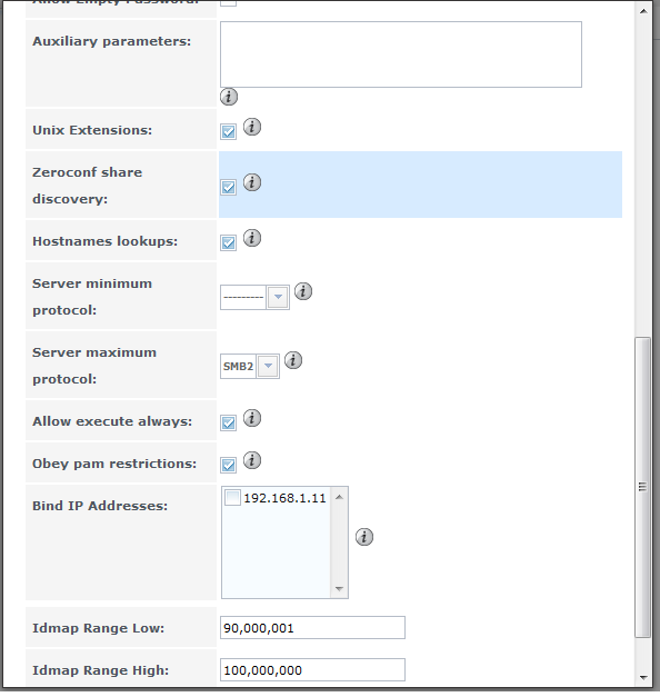

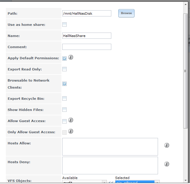

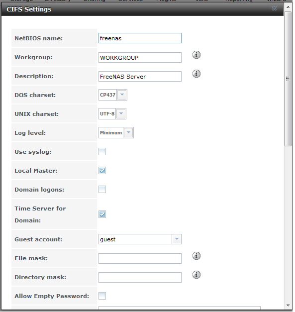

I've had to re-install FreeNAS recently (without my old configuration). In the process I've upgraded to version 9.3. So I'm fairly confident that I have most things set up properly, but I'm having one lingering issue that I can't quite resolve. As of now, from the CIFS share (from Windows 7) I can read and execute fine enough, butthe write seems a bit wonky though. I can usually change files or file names and create new files on the share. However, when I try to go through the Windows 7 properties context menu to change the Read Only characteristics (it's the same thing for hidden files as well), there is a message that I need administrator access (this is an administrator user on Windows), when I go to continue, I get an error that I don't have access. So I think there must be an issue with the permissions, but I thought everything is set to read/write in FreeNAS and I have the password of the owner of the storage equal to the Windows 7 password.
I had this issue before and solved it by using some other guide (https://forums.freenas.org/index.php?threads/cifs-windows-sharing-guide.20948/). I referred to that guide and I think everything is set up the same way.
Right now I have a root user, guest, and one that matches my Windows 7 login. Root and the Windows 7 login are both members of wheel. Storage permissions have been set so that the Windows 7 user is the owner and wheel is the group owner with Windows permission type, set recursively, and read/write/execute given to owner and group. The wizard created a share dataset when I set it up (wasn't there before), but I haven't noticed that files within the share folder it created have any difference in terms of being able to change the Read only setting.

Disable guest access to the share. Guest access is configured to map "bad users" to your guest account "guest". "Guest" is limited to the access specified by the "everyone@" ACE.
Once you have disabled guest access, verify that you are trying to access the server with your "john" credentials (the local account on your FreeNAS server). You should also post 'getfacl' output for /mnt/HallNasDisk rather than a subdirectory.
