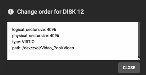

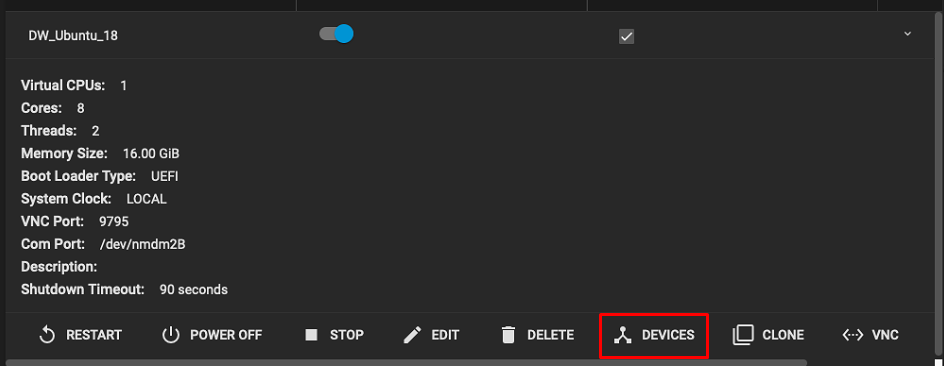

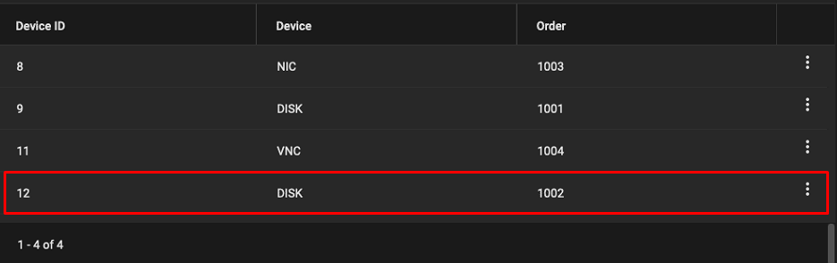

What do you mean by "device attached to a pool"?
Here are screenshots because I think I'm using the wrong terminology.
Patrick M. Hausen
Nov 25, 2013
7,776
Ah ... so you created a Zvol on the pool and use that as a block device for a virtual disk?
