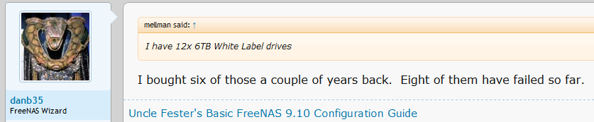

I'm leery of the white label drives. Some of our users have had bad experiences with them. Here's a reply from @danb35.
the drive in question is a whitelabel drive,

This is not an enterprise grade array, just an 18TB media storage server with about 400+ and growing bluray movies, 4k movies, home videos, DVR space for OTA antenna shows. Myself, wife and 4 kids consume the crap out of it on a daily basis though. All the movies and important stuff has been backed up on 2x 5TB USB drives. So in the end I think I would've lost 5 or 6 movies that hadn't been backed up if I'd had to rebuild the entire array. The recorded shows I could've watched from their own respective network apps, just without the ability to skip commercials. It would've been much more time consuming though because I also would have lost the OS VMDK containing the media server applications which I've not backed up in a while.
You can't beat $0.016/GB though. (~$50 per 3 TB drive)
Besides, the reduced reliability of these white label drives is exactly why I chose to go with raidz2. Great performance, cheap storage, and a bit more reliability than an average raid array. I think I'm doing pretty good on the Performance -> Cost -> Reliability triangle IMHO.

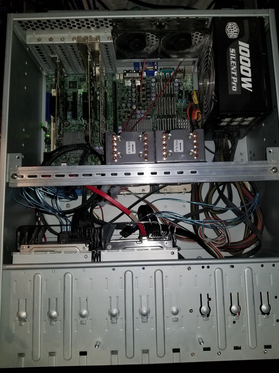

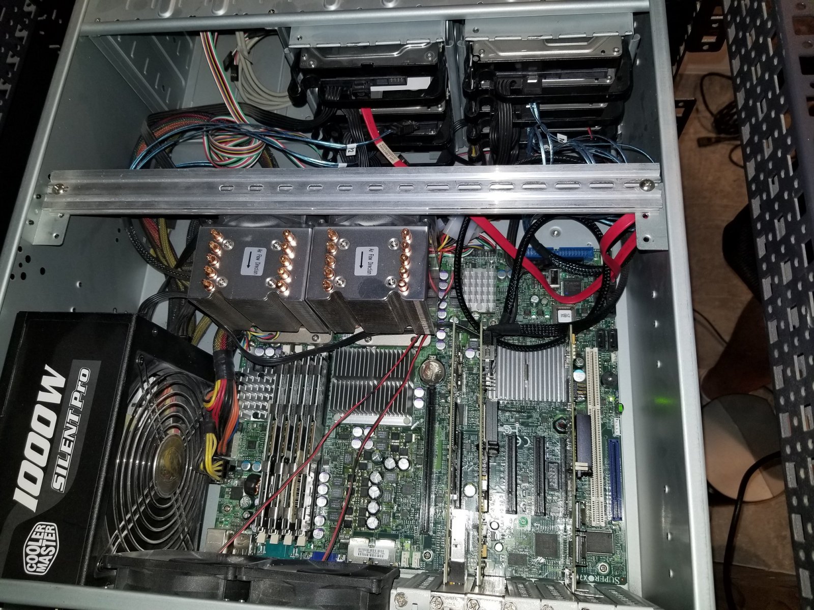

If you're willing, can I see a photo of the case internals (with the box fan moved for a moment, of course)?
More fans might not be necessary, just some airflow direction and targeted cooling (those toasty FB-DIMMs and the chipset) is likely all that's needed. That being said, check your IPMI and SMART logs to make sure your drives and CPU aren't getting too high.

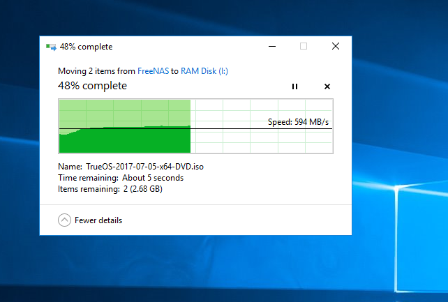

Maybe I can replace my 15k sas drives with ssd's soon
Unless you are hosting virtual machines, there is no need for either of those. I use 5900RPM desktop drives in both of my home NAS systems to serve media for Plex and they are plenty fast enough, for me.
andstein85
Apr 21, 2017
14
We're talking about 2 different boxes here... 1 is an IBM x3650m3 (2U) which runs all of my virtual machines, including my Cisco vWLC for my wifi access points and my firewall. That is the server that has the 15k SAS drives, simply because it came with them(free from work). They're tiny 146GB drives too, so I only keep the vWLC and firewall on them and some other OS stuff. No data. The other box is a custom built Supermicro X7DWE, which is my storage server and is dedicated FreeNAS. The media server's OS(windows server 2016 running Emby) runs on a separate LUN on the FreeNAS box because with the fibre channel interface, its by far way faster than the SAS drives on the local vmhost.
The drives stay at about 30-34C during load and the CPU's don't get above 38C.
Its basically everything else that's passively cooled...RAM, NB/SB chips. This Supermicro board was never designed to sit inside a PC style case that doesn't forcefully move air from front to back like my IBM x3650 does... This case is pretty terrible for airflow honestly, but it was cheap and still has tons of room for drive expansion.
Please keep in mind most of what you see are extra parts I had lying around.
