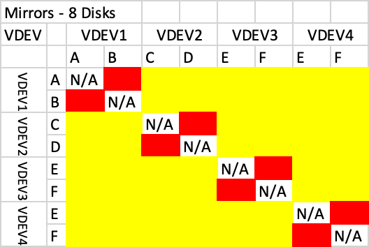

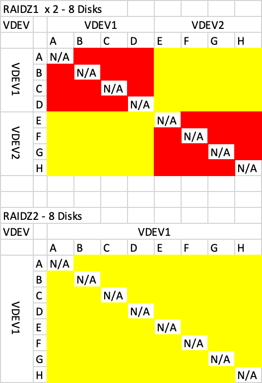

Depends how concerned you are about pool loss... Red cells indicate pool loss with the 2nd disk.
Clearly you can see RAIDZ2 is the only case where 2 lost disks isn't fatal for the pool.
