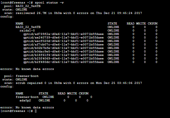

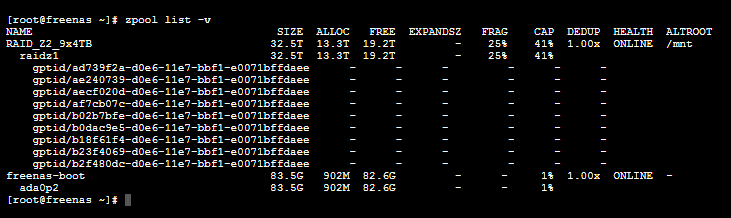

how many drives in the raidz1? size of drives?
do you have lots of open HDD ports?
you say you have a random assortment of drives, could you build a new raidz2 of the intended number of disks, with enough space to move everything from the old z1 to the z2, and then replace out all the random disks with the desired disks from the destroyed rz1?
perhaps you could post
zpool status -v
and
zpool list -v
for the relevant pool? (either from GUI shell or ssh)
moving jails and VM's would probably be easiest with zfs replication. if you can make a new disk pool big enough to move everything too, you could replicate the entire oldpool to newpool right from the GUI. if you need to split things up, you can also replicate to a file(or files) and then restore from the replication file to the replcatement pool
personally, the ease of management with mirrors (add/remove mirror disks, add new mirror pairs to pool), in addition to the faster resilver times, makes any of the raidz's less appealing, even at the cost of more drives

To go from RAIDZ1 to RAIDZ2, you will need to destroy and re-create the pool.
zpool status -v
and
zpool list -v
I don’t have enough drives to build a interim setup in that regard, although I may be able to build a large enough array to at least back up the most important data, VM’s and jails (since I don’t have those backed up anywhere). What exactly is ZFS replication, that sounds right up my ally here.
