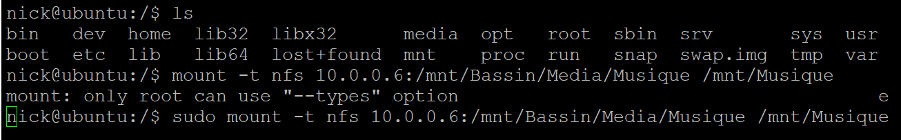

Any idea why each time I type the last character "e" of my mount, the cursor goes back to column 1 and I can't do anything but CTRL-C ?
It's like there is no carriage return at the 80th character
Patrick M. Hausen
Nov 25, 2013
7,776
How do you open your shell session to TrueNAS? Are you using an SSH client on your desktop or the "console" built into the web UI? The latter is broken. Don't use it if you can avoid it.
If you want to do anything with a Unix/Linux based system, learn how to use SSH.

I am in Solarwind Putty. First time I encounter such a behavior in Putty..
I SSHed to the host and used
truenas# cu -l /dev/nmdm20B
After the cariage return occured, I:
Then, I installled openSSH (whic was apparently not done at install) and started the service. The putty session went to a black screen. I was never asked for login credentials.
