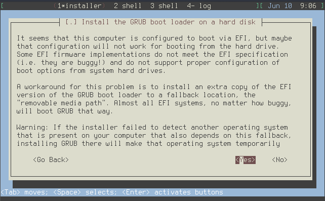

You can avoid the post-install EFI fix by running the debian installer in expert mode ( advanced options > expert install). Editing the boot command for the serial console as you showed is the same. At the "install GRUB" stage you should see this message:
First EFI boot should now succeed. These dirs/files are created:
root@de10serial:~# cd /boot/efi/EFI
root@de10serial:/boot/efi/EFI# ls -lR
total 8
drwx------ 2 root root 4096 Jun 10 09:15 BOOT
drwx------ 2 root root 4096 Jun 10 09:15 debian
./BOOT:
total 3968
-rwx------ 1 root root 1322936 Jun 10 09:18 BOOTX64.EFI
-rwx------ 1 root root 1206824 Jun 10 09:18 fbx64.efi
-rwx------ 1 root root 1529200 Jun 10 09:18 grubx64.efi
./debian:
total 5208
-rwx------ 1 root root     108 Jun 10 09:18 BOOTX64.CSV
-rwx------ 1 root root     117 Jun 10 09:18 grub.cfg
-rwx------ 1 root root 1261192 Jun 10 09:18 mmx64.efi
-rwx------ 1 root root 1322936 Jun 10 09:18 shimx64.efi
