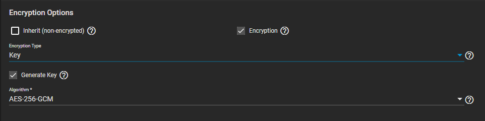

Thanks for your reply, but during creation of the pool I cannot switch from key to passphrase? At least I didnt see any possible checkbox or dropdown to do so. Only afterwards theres "encryption options" with the mentioned problem of having to move the system dataset.

Notice the arrow on the right by Key? You can select Passphrase after pulling down.

That looks differently on my system. I don't have the arrow, just for switching AES algorithms.

Yes, this is in the Encryption Options screen.

Ah ok, that's what I meant in the first post. I cannot switch from key to passphrase, because the system tells me there's the system dataset on that pool. But I only have one pool, I cannot move the system dataset anywhere else.

Unfortunately, this is a design limitation with the system dataset, which was introduced in 11.3 and GELI encryption. The system dataset can't wait for a passphrase on boot.
Of course, this only applies to the root dataset on the pool. You can have passphrases on daughter datasets.
