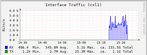

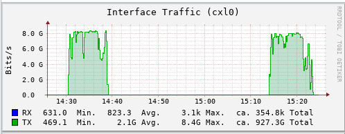

I keep running into things that make my head hurt. Check out these graphs as I do a storage Vmotion from one FreeNAS to the other.
Here is the primary which is sending to the secondary.
This is the secondary receiving from the primary.
Umm, what gives? The primary thinks it is sending at around 8G, but the secondary thinks it is receiving at around 5G. This is even borne out by the 10G switch.

 Peak value of output: 487844986 bytes/sec, at 2018-07-07 16:14:35
 Last 60 seconds input:  0 packets/sec 71 bytes/sec 0%
 Last 60 seconds output:  3 packets/sec 267 bytes/sec 0%
 Input (total):  846967891 packets, 825862710785 bytes
		 845964657 unicasts, 6602 broadcasts, 90842 multicasts, 905790 pauses
 Input (normal):  846062101 packets, - bytes
 Input:  0 input errors, 0 runts, 0 giants, 0 throttles
		 0 CRC, 0 frame, - overruns, 0 aborts
		 - ignored, - parity errors
 Output (total): 22223874523 packets, 31368788373114 bytes
		 22192840289 unicasts, 4625 broadcasts, 3178073 multicasts, 13925768 pauses
 Output (normal): 22196022987 packets, - bytes
 Output: 0 output errors, - underruns, - buffer failures
		 0 aborts, 0 deferred, 0 collisions, 0 late collisions
		 0 lost carrier, - no carrier
<HP-5820X-14XG>dis interface Ten-GigabitEthernet1/0/14
 Ten-GigabitEthernet1/0/14 current state: UP
 IP Packet Frame Type: PKTFMT_ETHNT_2, Hardware Address: b8af-673a-bcab
 Description: FreeNAS - P2
 Loopback is not set
 Media type is optical fiber,Port hardware type is 10G_BASE_SR_SFP
 10Gbps-speed mode, full-duplex mode
 Link speed type is autonegotiation, link duplex type is autonegotiation
 Flow-control is enabled
 The Maximum Frame Length is 10000
 Broadcast MAX-ratio: 100%
 Unicast MAX-ratio: 100%
 Multicast MAX-ratio: 100%
 Allow jumbo frame to pass
 PVID: 252
 Mdi type: auto
 Port link-type: access
  Tagged   VLAN ID : none
  Untagged VLAN ID : 252
 Port priority: 0
 Last clearing of counters:  Never
 Peak value of input: 1050871408 bytes/sec, at 2018-11-09 14:12:17
 Peak value of output: 591856141 bytes/sec, at 2018-11-09 15:21:27
 Last 60 seconds input:  316684 packets/sec 480523762 bytes/sec 39%
 Last 60 seconds output:  50993 packets/sec 4427540 bytes/sec 0%
 Input (total):  14448754836 packets, 17649207961868 bytes
		 14447889036 unicasts, 9436 broadcasts, 90496 multicasts, 761296 pauses
 Input (normal):  14447988968 packets, - bytes
 Output (total): 7831947009 packets, 10649371113747 bytes
		 7768967085 unicasts, 20624 broadcasts, 561981 multicasts, 31198967 pauses
 Output (normal): 7769549690 packets, - bytes
The pauses are only displayed on the physical links, not on the bridge-aggregation interface (LAGG in H-P/H3C speak). Perhaps I need to do some iperf stuff between FreeNAS units and see what that gets. It sure looks like something is telling my network to slow down.
Dec 29, 2014
1,135
It certainly appears that any slowness is not related to the network. See my iperf3 results below:
root@freenas2:/nonexistent # iperf3 -c 192.168.252.23
Connecting to host 192.168.252.23, port 5201
[  5] local 192.168.252.27 port 16505 connected to 192.168.252.23 port 5201
[ ID] Interval		   Transfer	 Bitrate		 Retr  Cwnd
[  5]   0.00-1.00   sec  1.10 GBytes  9.43 Gbits/sec	0   3.19 MBytes
[  5]   1.00-2.00   sec  1.10 GBytes  9.42 Gbits/sec	0   3.19 MBytes
[  5]   2.00-3.00   sec  1.10 GBytes  9.42 Gbits/sec	0   3.19 MBytes
[  5]   3.00-4.00   sec  1.10 GBytes  9.42 Gbits/sec	0   3.19 MBytes
[  5]   4.00-5.00   sec  1.10 GBytes  9.42 Gbits/sec	0   3.20 MBytes
[  5]   5.00-6.00   sec  1.10 GBytes  9.42 Gbits/sec	0   3.20 MBytes
[  5]   6.00-7.00   sec  1.10 GBytes  9.42 Gbits/sec	0   3.20 MBytes
[  5]   7.00-8.00   sec  1.10 GBytes  9.42 Gbits/sec	0   3.20 MBytes
[  5]   8.00-9.00   sec  1.10 GBytes  9.42 Gbits/sec	0   3.20 MBytes
[  5]   9.00-10.00  sec  1.10 GBytes  9.42 Gbits/sec	0   3.23 MBytes
[  5]   0.00-10.00  sec  11.0 GBytes  9.42 Gbits/sec	0			 sender
[  5]   0.00-10.00  sec  11.0 GBytes  9.41 Gbits/sec				  receiver
iperf Done.
root@freenas2:/nonexistent # iperf3 -s
Server listening on 5201
Accepted connection from 192.168.252.23, port 44637
[  5] local 192.168.252.27 port 5201 connected to 192.168.252.23 port 62120
[  5]   0.00-1.00   sec  1.02 GBytes  8.80 Gbits/sec
[  5]   8.00-9.00   sec  1.10 GBytes  9.41 Gbits/sec
[  5]  10.00-10.06  sec  71.4 MBytes  9.42 Gbits/sec
[  5]   0.00-10.06  sec  11.0 GBytes  9.35 Gbits/sec				  receiver
