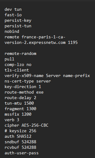

remove or comment out "keysize" in your config as a start.

I deleted/commented out the keysize line but the problem persists. I would like to point out that qBittorrent works correctly when the VPN is not added but does not launch as soon as the VPN configuration is set
2023-04-15 20:19:45.843795+00:00mknod: /dev/net/tun: Operation not permitted
2023-04-15 20:19:45.844279+00:00+ exec sg vpn -c 'openvpn --cd /vpn --config /vpn/vpn.conf --script-security 2 --redirect-gateway def1 '
2023-04-15 20:19:45.845619+00:00Sat Apr 15 22:19:45 2023 OpenVPN 2.4.9 x86_64-alpine-linux-musl [SSL (OpenSSL)] [LZO] [LZ4] [EPOLL] [MH/PKTINFO] [AEAD] built on Apr 20 2020
2023-04-15 20:19:45.845641+00:00Sat Apr 15 22:19:45 2023 library versions: OpenSSL 1.1.1g 21 Apr 2020, LZO 2.10
2023-04-15 20:19:45.845646+00:00Sat Apr 15 22:19:45 2023 neither stdin nor stderr are a tty device and you have neither a controlling tty nor systemd - can't ask for 'Enter Auth Username:'. If you used --daemon, you need to use --askpass to make passphrase-protected keys work, and you can not use --auth-nocache.
2023-04-15 20:19:45.845651+00:00Sat Apr 15 22:19:45 2023 Exiting due to fatal error
