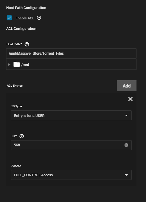

Just made the migration from Core to Scale to play with some of the supported apps.
Wile attempting to deploy qBittorrent everything appears to go smoothly, until I attempt to download a torrent.
While attempting to do so it Errors. The "Execution Log" reports:
File error alert. Torrent: "ubuntu-23.10.1-desktop-amd64.iso". File: "/Torrent_Files/ubuntu-23.10.1-desktop-amd64.iso". Reason: "ubuntu-23.10.1-desktop-amd64.iso mkdir (/Torrent_Files/ubuntu-23.10.1-desktop-amd64.iso) error: Read-only file system"
Looks to be a permission issue. Although when I set up the app I set the USER ID 568 to FULL_CONTROL Access to the location in question, but it still doesn't have access.

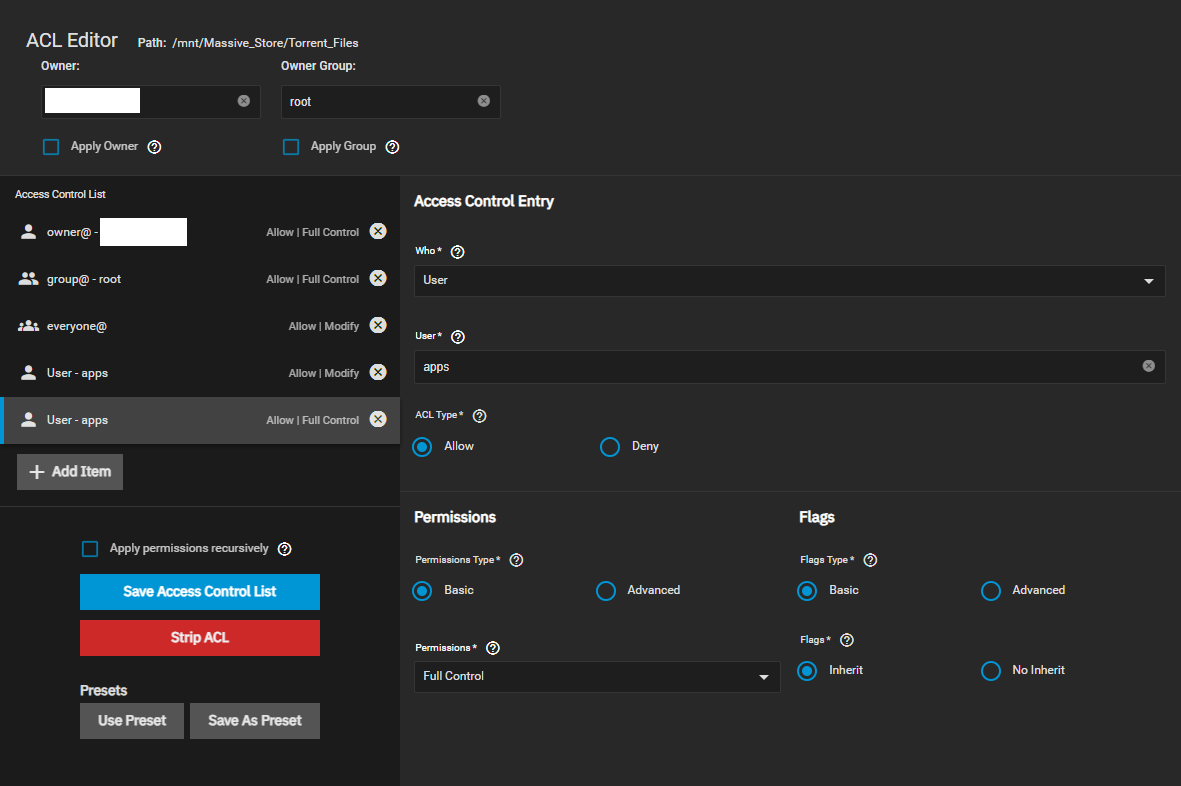

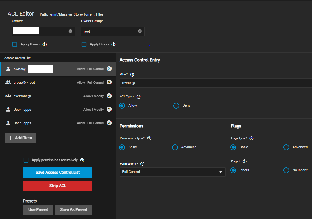

When I go to check the share permissions, the USER ID isn't listed, although I see "User - apps"
Not sure when the permissions system changed, but I guess I've not had to make permission changes since before the change to ACL permissions.

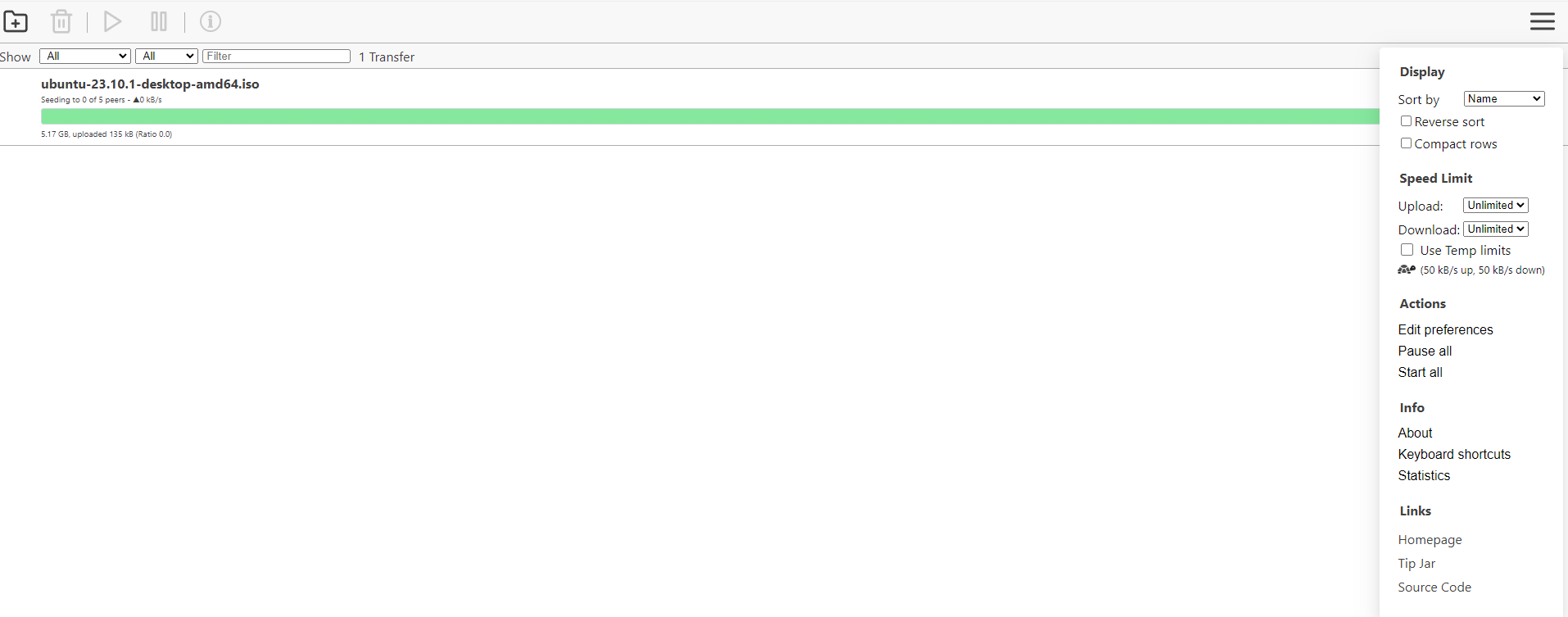

** UPDATE **
Interesting update. I still can't get qBittorrent to work but I gave Transmission a shot, same user, same location and it works. Seems odd that this would be the case.
