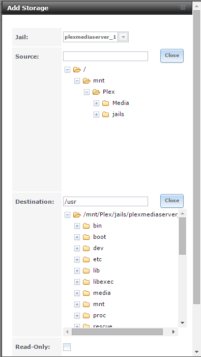

So one question before I go messing things up. I want to add a file to a different folder of the plex jail. I tried adding storage to the plex jail, source of the folder inside the jail, and destination of a dataset outside of the jail. I then shared it through CIFS, and accessed that share, however it is coming up completely blank even though I know for a fact it has files and folders inside of it.

Okay, so basically I was trying to add storage to the jail so that the source went to a folder like "/mnt/Plex/Plex Data", with the destination as a folder in the jail similar to "bin" as shown in the screenshot. When I shared that dataset of /mnt/Plex/Plex Data" and browsed to that share, I didn't see any files inside "bin".
I think it has to do with what you said, the dataset is hiding them. Hmmm. I'm going to have to figure out a way to get this file in the jail then.
  1. Right, when you mount storage in a folder in a jail, it hides whatever was in that folder. If this is the issue, the simplest fix is to move the data from the jail to the dataset first.
  2. I assume you're just using it as an example, but /bin would be a bad choice of mount point, since it's one of the places where FreeBSD expects to find executables. The conventional place to mount storage in a jail is /media. On a standalone system this is where removable devices show up, so there's a kind of logic to it, and in a jail it starts out empty. You can also create a new folder in the jail someplace and use that.
Now, are you saying you already have data in /mnt/Plex/Plex Data, but you can't see it in the share?

Oh, I see. Not that I put in there. When I do what I mentioned, set the destination to /usr, then browse to that share, it shows up blank.
What I do is I add the storage to the jail, source is a dataset, "Plex Data", destination is "/usr" of the Plex jail (which has other folders and files inside it). I then share through CIFS the dataset, "Plex Data". Once I browse that share, it will show up nothing.
Yes, you can't do it that way. Mounting the dataset to /usr hides the current contents of /usr.
The area I actually wanted it to show was /usr. The reason is because through the path of usr is a folder I need to add a file to for Plex. An agent, so that it can scan different files more appropriately.
If this is a temporary share just to copy something into the jail, it may be easier to use something like FileZilla to connect to your FreeNAS and copy the file directly where you want it. You could even just copy it to some existing share, then move it wherever you want using the command line. You could also use scp or rsync. In your example, it looks like the full path to the jail's /usr folder would be /mnt/Plex/jails/plexmediaserver_1/usr
There are so many options, none of which will work if you've hidden the destination by mounting storage to it.
