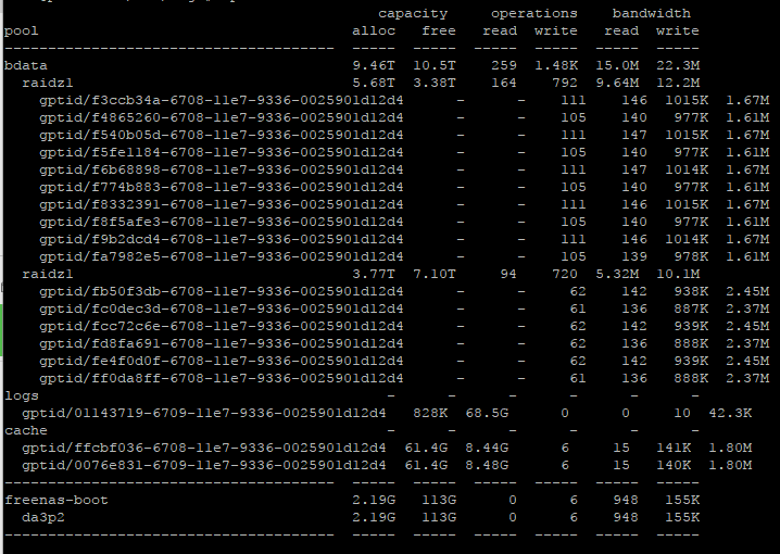

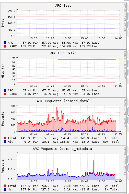

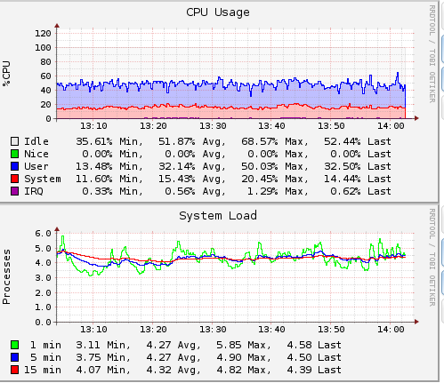

i have change the os from debian to freenas to use zfs sensible. Now is the system complete and all services run! The system is only for backup services! I have rsync tasks, nfs+samba shares and one iscsi lun on one vol. All services run on the same zfs pool. i use a lot of memory and the cpu load, caching is ok. The system is up2date(FreeNAS-11.0-U3 (c5dcf4416)) and have two Xeon E5506 cpus. The controller is a LSI MegaRAID SAS 9261-8i anbd all disks are raid0 arrays.

Just for curiosity: why you have a pool with two raidz1 vdevs which one have 10 drives and the other 6? Is there any perfomance gain by having this configuration?

Thanks for the answers!! #artion: The disks have different sizes. i had try it with one raidz1 and so but the problems were the same. The disks have different sizes.

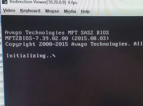

my last test was wit an other controller (LSI SAS 9205-8e in it mode) . but i think the controller had problems with the expander. :-(
