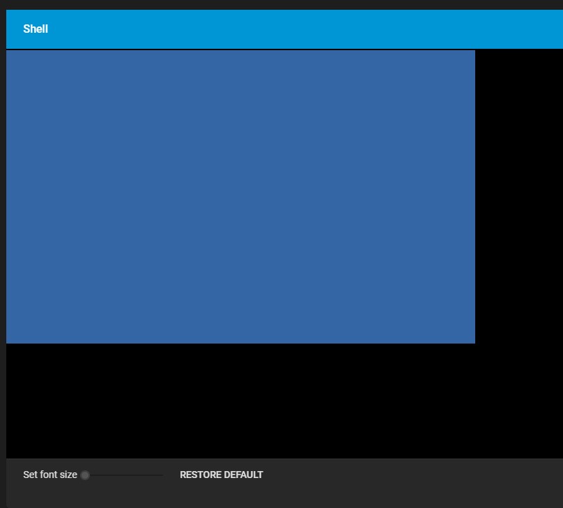

I installed the port using the Makefile in /usr/ports/net/eturnal and received this blue screen (BSOD,lol?). I'm not sure this is normal. The shell was unresponsive afterwards.
I opened another shell within the jail and ran 'pkg install eturnal' and received the response: 'pkg: No packages available to install matching 'eturnal' have been found in the repositories.
Thanks again Patrick!

You must upgrade your jail to a supported FreeBSD release, first, before you can even consider using packages or ports.
The only supported release running on TN CORE today is 13.2. Upgrades of jails are performed with iocage upgrade on the NAS host system. You also must run TN CORE 13.0 to use 13.2 jails. TN CORE 12 is also EOL and has been for quite some time.
Upgrading an existing jail might well break already installed applications, so better take snapshots or deploy a completely new jail right away.
