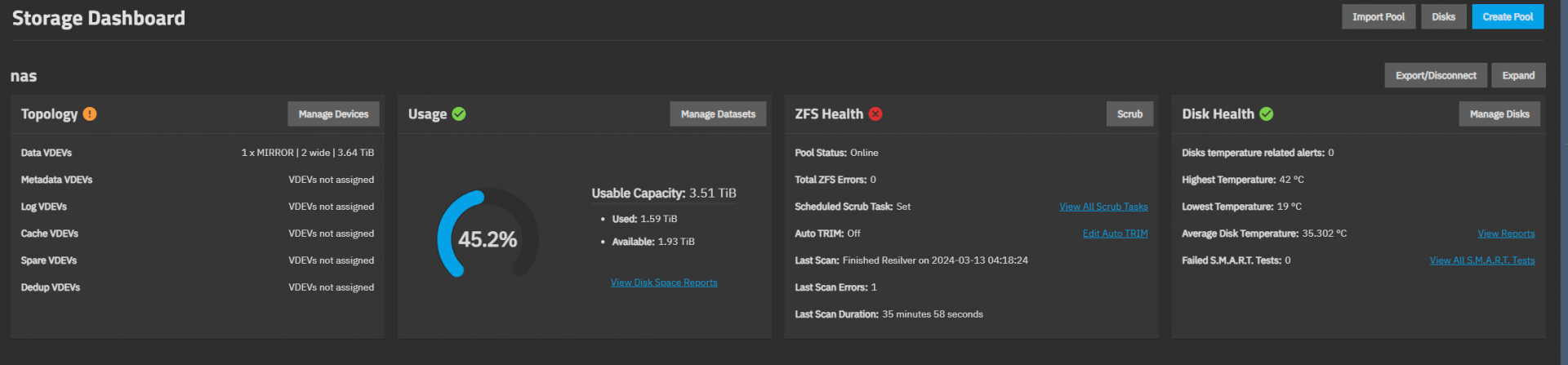

Hello,
Recently i have problems with my disks. 2x 4TB Ironwolfs (red nas). What can i do to delete errors in Truenas. There were 2 errors before, now i see 8 errors on disk.

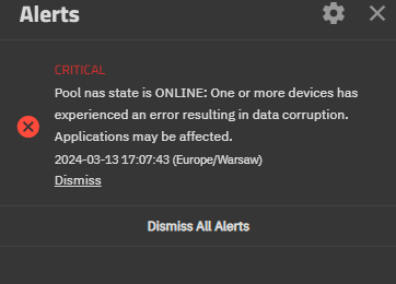

But still i have unhealthy topology and zfs healthy pool is not healthy
And i have critical alert.

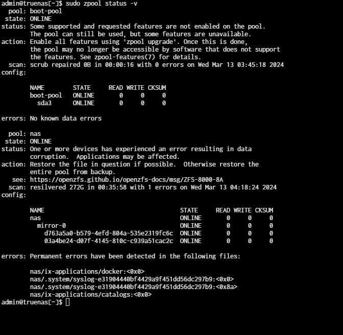

i missed it before but I see that you had 8 errors on each vdev in the mirror. that means dataloss, as zfs does not have an uncorrupted copy to work with. you will have to delete or replace the files. they have been permanently damaged.
as the corrupted files are in your .system and applications dataset, though. hmm. im not sure how best to replace those. should be able to just delete the syslog ones but the catalogs and docker would affect applications - are you using applications?

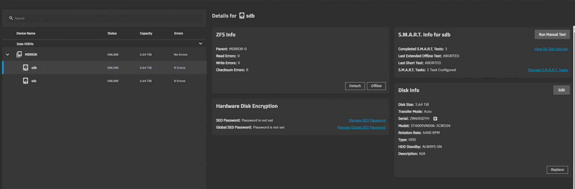

ikon_pl
Mar 11, 2024
8

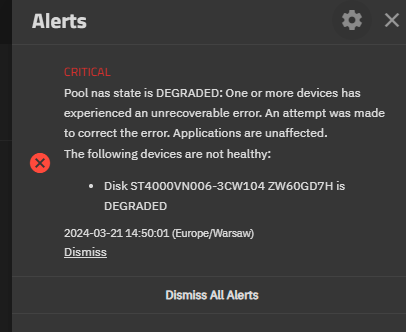

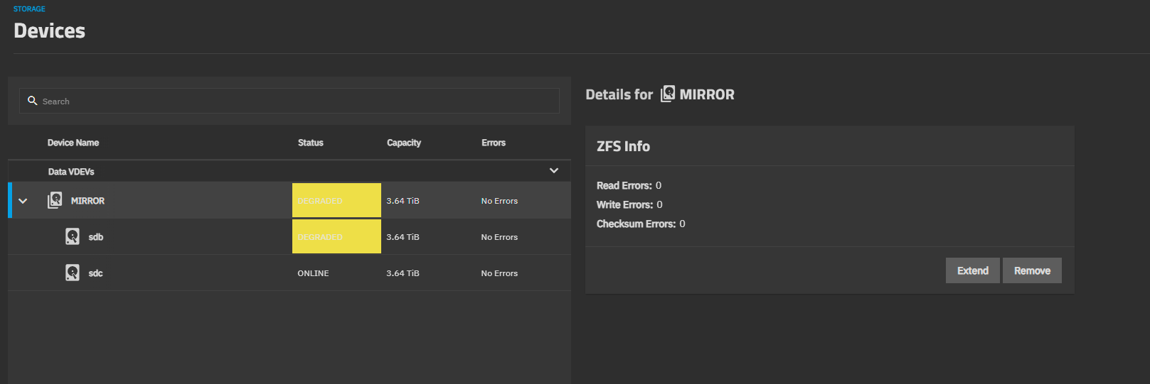

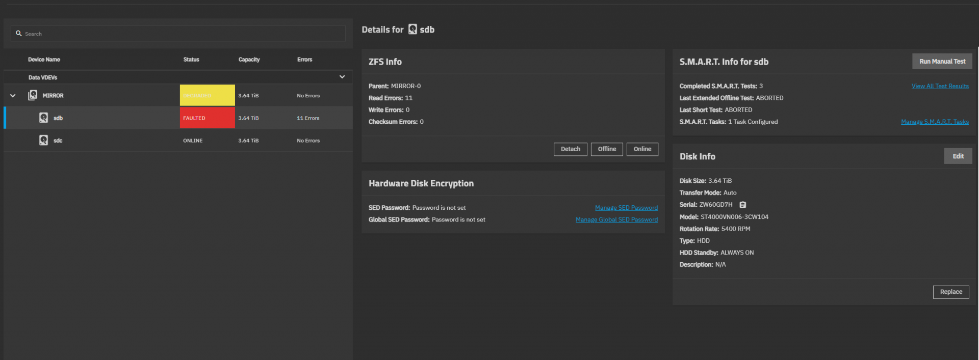

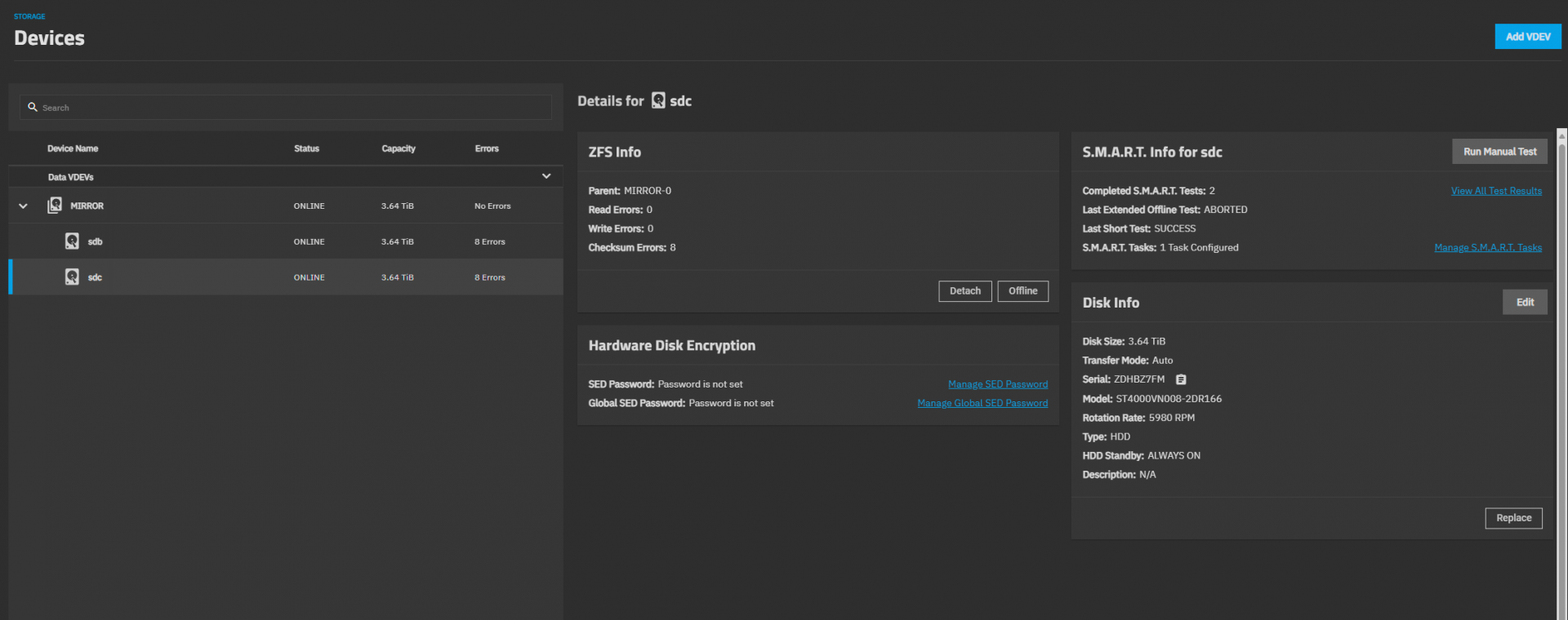

I'm turn on my nas now, use nextcloud on phone and see 54 errors on truenas (with one disk this errors). So i restart truenas and now this one disk is degraded, what does it mean?What i must do?
And after one more restart
