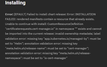

After restoring everything my apps wont load by choosing the new pool.
I got an error called: filesystem 'ix-applications/k3s/kubelet' cannot be mounted using 'mount'. Use 'zfs set mountpoint=legacy' or 'zfs mount /ix-applications/k3s/kubelet'.
First i tried: "zfs set mountpoint=/DataPool/ix-applications/k3s/kubelet DataPool/ix-applications/k3s/kubelet" with no success
but if i use: "zfs set mountpoint=legacy DataPool/ix-applications/k3s/kubelet" it works just fine ....
Why is that so? Why happens that after a recovery?
What is the difference between legacy and a straight mountpoint?
As i read more ... and that wasnt said by anyone when talking about replication tasks to back up on a usb drive ... its quite better to select choose pool in apps to replicate the apps on the new dataset and then rechoose the originally ... but i dont get why ...
EDIT okay i give up ....
next errors ... apps arent operable ... i have no clew wharts going on .... acl problems? i dont know ... i have seen many apps/ os but thats is just a mess whats going on ...
