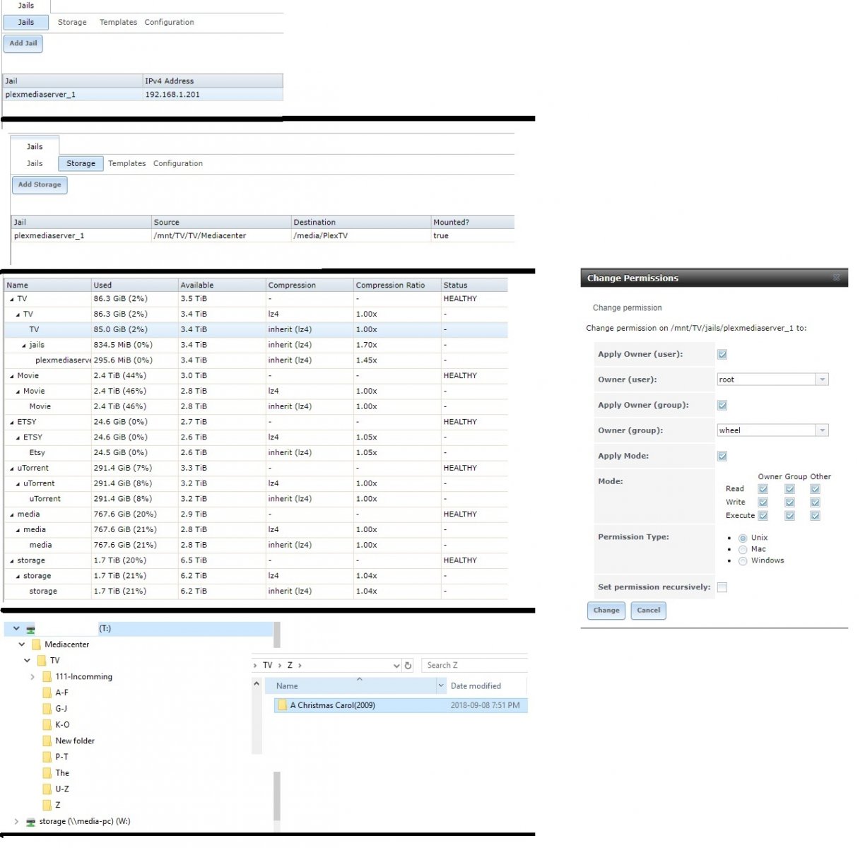

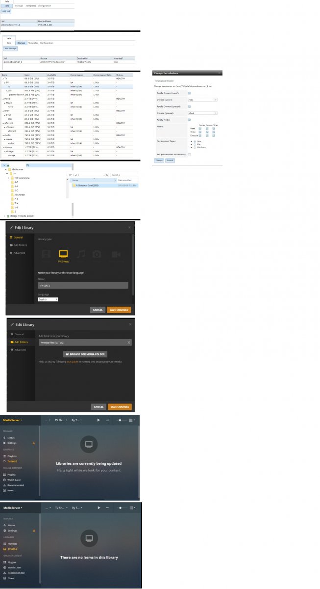

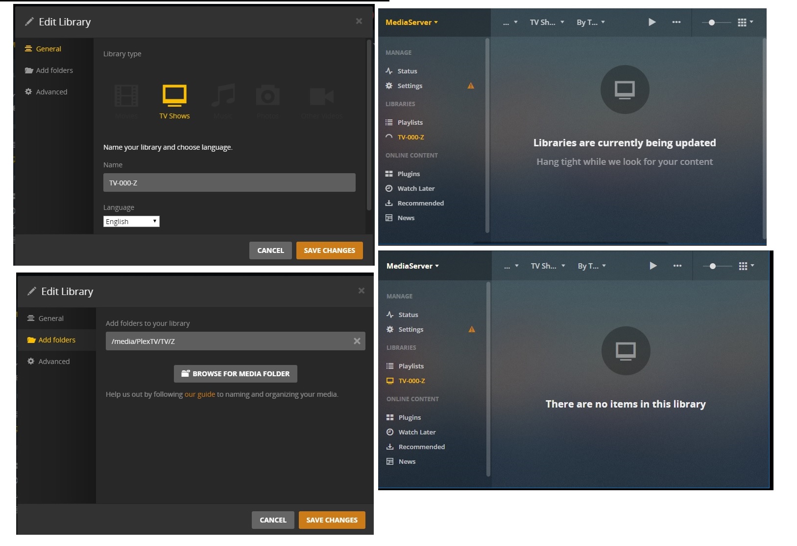

Hello!
I am fairly new to FreeNas, I think I know enough to be dangerous, and I have decided to install PLEX. II think everything is working, but its not detecting the movies I have in the folder.
I HOPE to be able to setup multople pools for PLEX to pull movies from , but I figure I should start with one first.
I am not sure what information is needed, so I am going to brain dump everything I have done and hopefully someone can steer me in the right direction:
Free Nas ver: FreeNAS-11.1-U5
Plex: Version 3.39.5
I have watched so many video's my head is swimming. I think I have it set up right but I would love someone to take a second look.
attached are all the screen shoots that are relevanr.
please someone help me figure out what I missed. please and thanks.

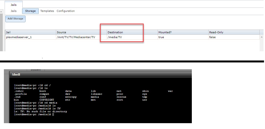

after reading a few more threads, I have come to the conclusion I should be able to see my mounts in /media?
but obviously, its not mounting. so maybe I am doing something wrong?

The storage tab shows the source (your FreeNAS machine) and the destination (your jail). A jail has its own root tree.. you need to do ls from the jail to see your files in the destination. Did you read the manual? If you have questions on the manual content please quote the text you don’t understand.

I would like to offer this piece of advise to anyone who finds this thread after I post it, and would like to better understand what happened.
first of all, there are 2 SHELL menu's, there is the one in the main UI, and then there is a Shell when you select the JAIL. as Garm pointed out. the Jail runs in its own baseline. so start from there.
also, remember that when you create a "storage entity" the first point is "where the hard drive" is. and the second, is where the mapping to the JAIL.
so, I had :
/mnt/volume1/HD1/TV which I mounted to /media/TV
and
/mnt/volume2/HD2/movie which I mounted to /media/Movie
When when I used PLEX, I just needed to map too "/media/Movie" or "/media/TV" to be able to browse through multiple hard drives. as well, there is now browse functionality. but you can use your Windows PC to figure out the destination you want to make too.
