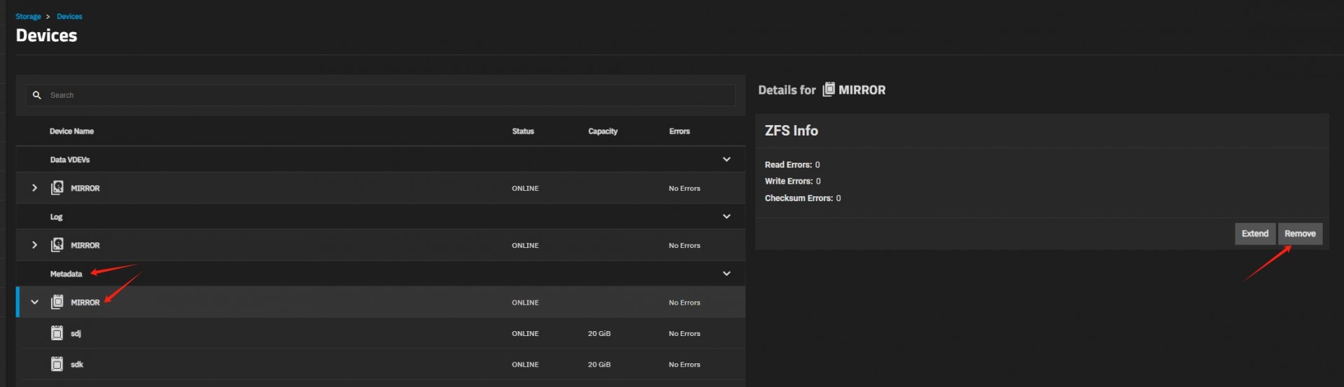

One day I found metadata only used 103G,so I try to change a small one.Then create a test system.
Same Truenas ver,same PVE8.0.2.
zpool iostat -v
capacity operations bandwidth
pool alloc free read write read write
boot-pool 5.00G 26.0G 0 1 617 20.6K
sda3 5.00G 26.0G 0 1 617 20.6K
test 27.1G 21.9G 0 1 29 10.8K
mirror-0 27.1G 2.43G 0 0 13 1.01K
8d3f4a5f-099d-4d58-b80c-6a836bbf68e0 - - 0 0 8 516
a193f17c-12e8-40ed-80fa-326b09bb9484 - - 0 0 5 516
special - - - - - -
mirror-5 79.4M 19.4G 0 1 13 9.69K
c484d377-d805-4ba5-a91e-9dca49c34df5 - - 0 0 6 4.85K
1a8ad8c5-7f38-4b8c-8458-3568788bc6ce - - 0 0 6 4.85K
logs - - - - - -
mirror-7 0 31.5G 0 0 3 129
ac8f3c48-06e5-499e-84a8-08fbcd88f34a - - 0 0 1 64
0dbd932d-688b-4baa-9f51-5833771bb37c - - 0 0 1 64
Then I can see remove here in GUI.
and 2* 32G vdev,then can still remove 20G vdev mirror,or remove all of two mirror.
I add 2*100G vdev to first system,and they can`t be remove. Old 230G metadata vdev can`t remove too.
special - - - - - -
mirror-2 102G 126G 92 44 643K 506K
622fdec2-6a56-4280-9607-8367b74ddf58 - - 45 21 317K 253K
d00af9d8-927b-4526-9656-382a024767b3 - - 46 22 327K 253K
mirror-5 83.2M 99.4G 0 27 698 302K
038fd86e-0f39-4769-b3de-33980279d58d - - 0 13 398 147K
ca99fa06-1613-4090-8f98-11fd562ac13c - - 0 13 278 147K
I fill some data to test pool. about 95% used ,and create a share,the metadata vdev still can be remove.
I can`t understand.Did someone meet this before?Thanks!

When using RAID-Z1 as the data portion of the ZFS pool, you can not remove critical members, (or shrink), of special vDevs. Special vDevs are De-Dup, Special or Small file.
In your example, you use Mirror instead of RAID-Z1, thus, you are able to remove Mirror devices.
