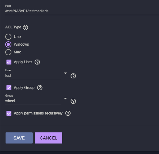

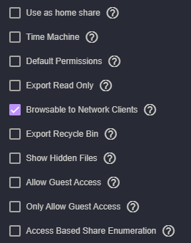

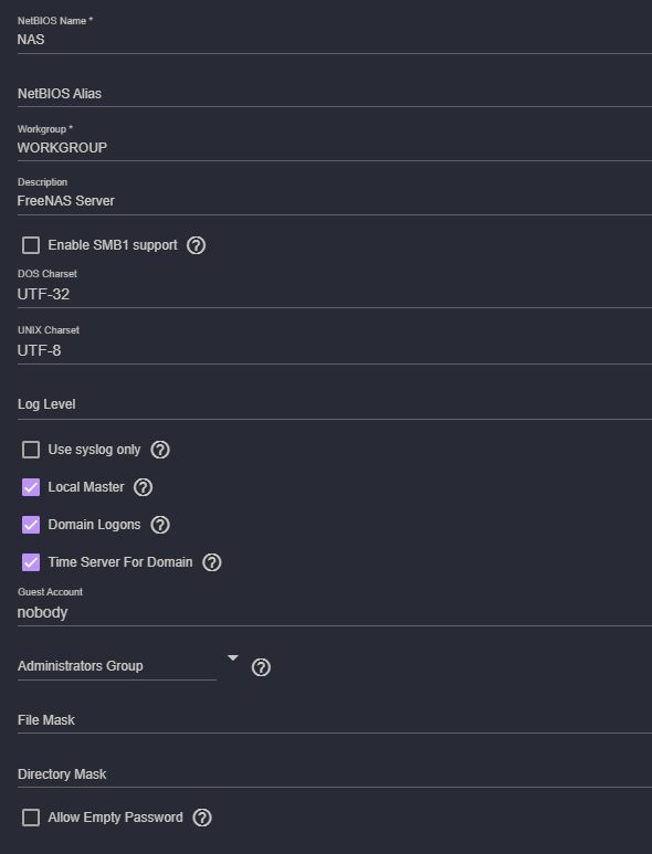

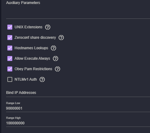

Hello, im new using FreeNAS and yesterday i was starting to use it. I created a pool, a dataset, an user and set dataset permissions for this user but when i try to create a SMB Shared Path i create that but in Windows 10 (i have 1903 version) i cant access to this folder. I tried restarting the service and the server but the error persist.
i attach its screenshots of the process and the error on windows (sorry my Windows are in Spanish)

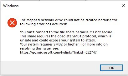

I forgot attach the Error Messages.
The first is about that cant see the directory and the second is about that FreeNAS are trying to use SMB1 and Windows accept only SMB2 or above but in the config file (smb4.conf) the min version of server are setted as SMB2 and the SMB1 are disabled on FreeNAS

Did you set your SMB share to be "Browseable to Network Clients" in FreeNAS? That's easily missed as the checkbox is not visible unless you use advanced mode when defining a SMB share. I've not seen your error in windows10 1903 pro myself. What does net view \\192.168.50.148 return at the cmd prompt or in powershell?
Navok
Sep 28, 2019
13
The option "Browseable to Network Clients" are enabled.
And when i execute net view \\192.168.50.148 or net view \\192.168.50.148\medialib says "Sistem Error 53: The network path was not found."

What happens if you uncheck "hostname looksups" in your SMB service config ( your 2nd image)?
Navok
Sep 28, 2019
13

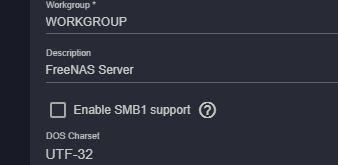

Nothing special, says "System Error 53" and if i try to add a network drive says that the server is trying to connect with protocol SMB1 but i don't have the SMB1 option active.
I tried adding auxiliary params to set the protocol version to SMB3 or SMB2_10 but nothing happen

I executed
There were some design decisions in FN 9-11.2 that can cause the passdb.tdb file to get out of sync with what is in the GUI. Try the following:
rm /var/db/samba4/private/passdb.tdb
rm /var/db/samba4/.usersimported
service ix-pre-samba start
This forces the webui users to be re-imported into samba's passdb.tdb file.
I executed the instructions but nothing happens. The problem still here.
If i try to add a Network Drive on windows 10 it says an error that its trying to connect using SMB1 protocol and is not supported but i don't have this option selected on my FreeNAS and i don't want to enable SMB1 on windows 10 because is unsecure.
I deleted all pools and shared paths and create new again, then re-execute the instruction to sync the passdb and nothing happens
anodos
Sambassador
Mar 6, 2014
9,554
Take a pcap of the session and PM it to me. On FreeNAS tcpdump -i <interface name, i.e. "igb0"> -w /tmp/smb.pcap -p -s 0 host <ip of windows client>
