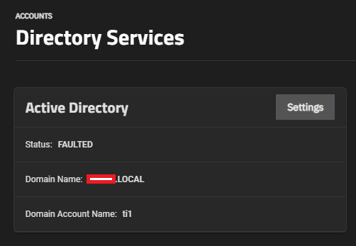

I try to configure a new fresh instalation of TrueNAS Scale with Active Directory integration.
Version: TrueNAS-SCALE-22.12.1
Hardware: eSXI VM with 12gb RAM and 20GB VHD
My domain is working fine, and the testes with Core version and anothers machines works well.
My DNS is working in all tests.
Once install TrueNAS, i chooseed Admin authenticantion method.

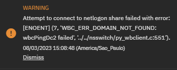

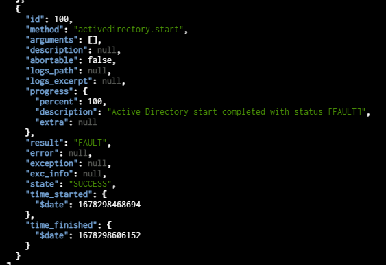

When i try to join to domain, the results is FAULTED.
Here the logs:

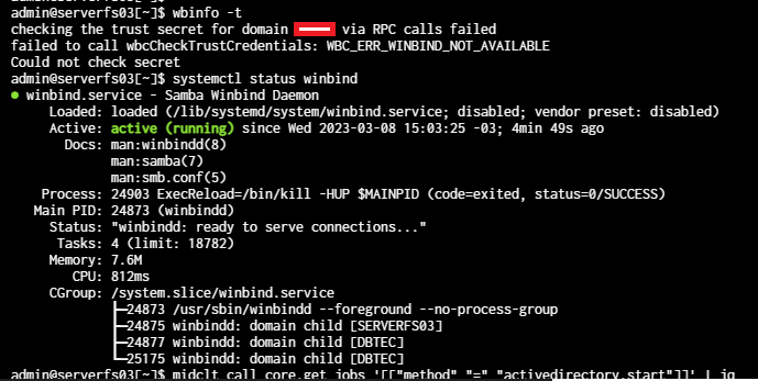

midclt call core.get_jobs '[["method","=","activedirectory.start"]]' | jq

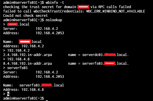

1 - Is a LAB. The VHD disk is only for the OS instalation. The file pools is over a PERC 330 Controler in HBA mode. Yes, no relevant here. Is the instalation moment. No pools configured yet.
2 - Static IP. The DNS Server is the Domain Controler. Look the prints. One of them is the nslookup DNS tests.
3 - Yes, i can ping the domain.
