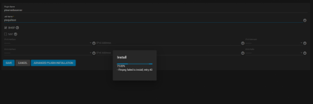

I want to stress that I am a complete novice, and have installed this using the TrueNAS yt videos.

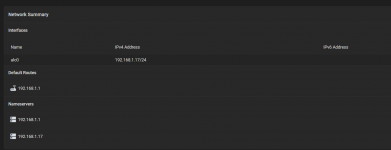

I have watched the install videos but am running into some errors (attached screenshots). I have also looked at the following thread (https://www.truenas.com/community/t...-while-re-installing-plex-media-server.90763/), but I am lost on some of the technical aspects discussed in the thread.
Error text:
50.00%
- ffmpeg
pkg failed to install, retry #1
75.00%
- ffmpeg failed to install, retry #2

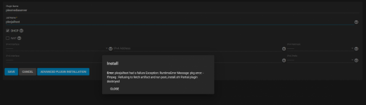

Error: plex2 had a failure Exception: RuntimeError Message: pkg error: - Please check your network Partial plugin destroyed

Are you installing via the “Plugin” method or the manual jail method?
Update: I would try just the manual jail method.
