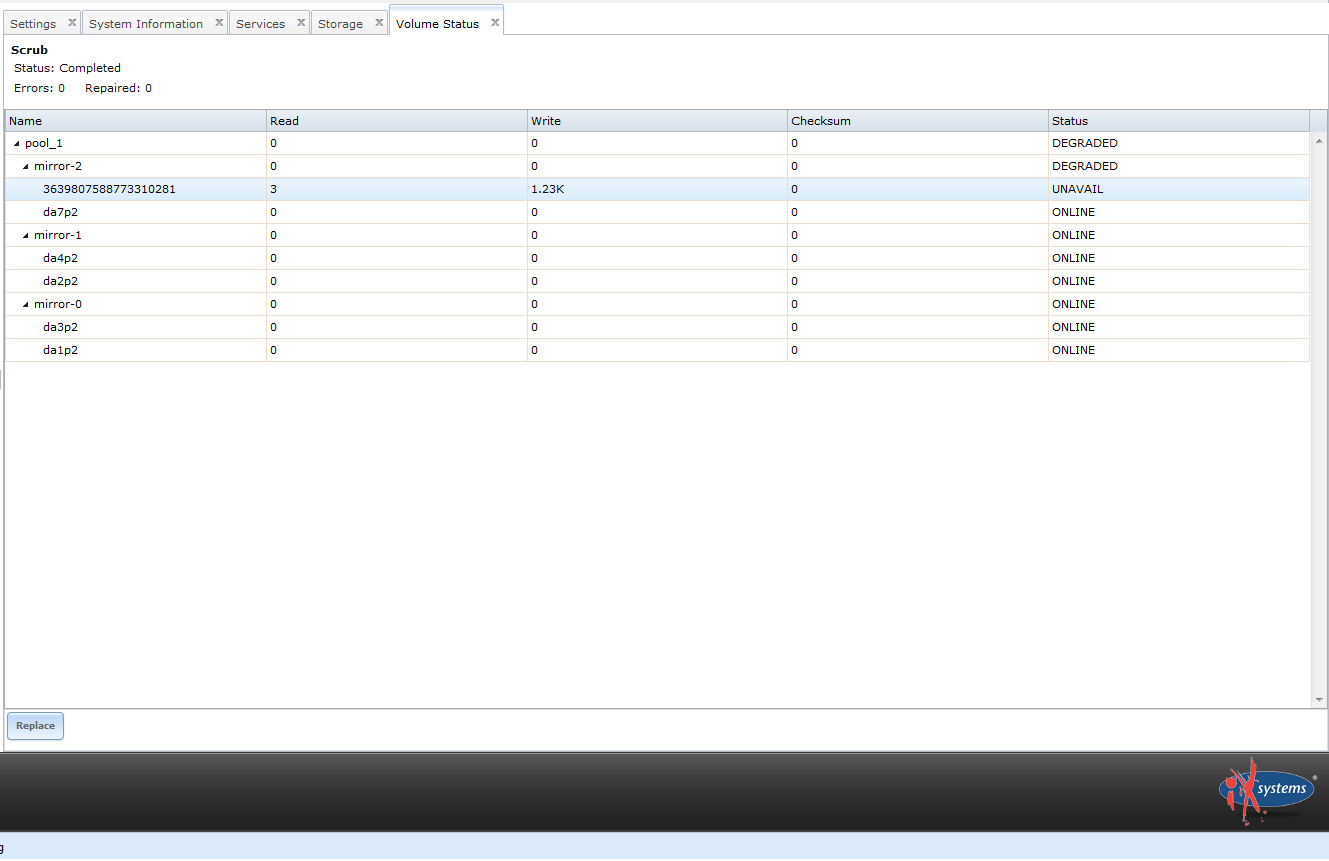

I think I have a similar problem again. A few minutes ago I got a mail that my pool is Degraded again. This time I made a screenshot of the detail view. As you can see in the screenshot there is no option to take the UNAVAIL drive offline. What is the best way to replace this drive?
Edit: Ok so there was no way to take the drive offline using the GUI, I just used the replace button to get the new drive "online". I now ran into the same problem like last time. Maybe this will help you find and fix the problem in freenas.

So, your replacement drive is now online and resilvered, but you can't rekey the encryption, correct?
Harsesis
Jan 21, 2014
95
Yap, same problem appeared like last time. I solved it using the query you gave me last time (with the new id).
