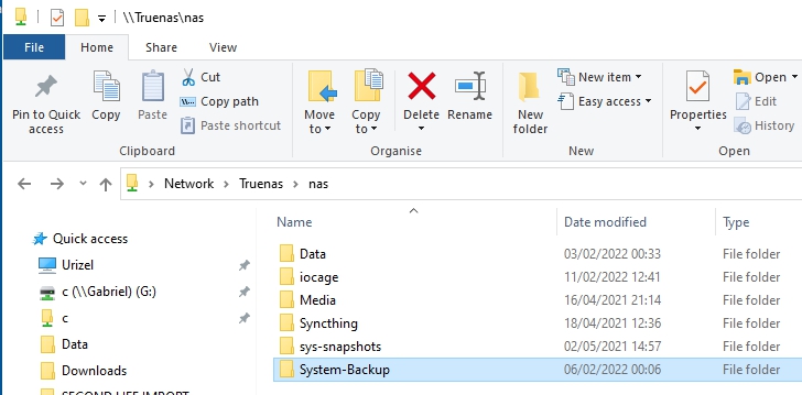

Here's what I see of my NAS pool from Windows:
Notice "iocage" was created yesterday, after I moved all system related elements to the SSD. So that's TrueNAS's active iocage. Currently it contains no jails and no plugins. It just exists.

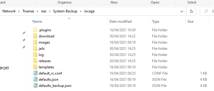

Now turning attention to the last item in the above list, 'System-Backups' is just that - my backups of everything from the former SSD. So if I drill down into it I see the following:
So, within 'System-Backups', I have 'iocage' and all it's associated sub-directories and files.
Can I copy the one folder over the other, and will that fix my loss? Can I do any damage to the wider system by attempting that? And lastly, if you can give that a green light, is there any special shell command I should use to do it, or can I copy A over B from Windows for the same result? Or can/should my Snapshots save me by some means?

It might be safer to just create the new Plugins/Jails again, make sure they can run, and then finally copy the relevant config folders/files from the backup (using the Shell or command-line).
Each Plugin/Jail will be different. It depends where Syncthing and Grafana save their configs.
The "root" folder nested under a jail's exclusive dataset is where the filesystem tree starts. So for example, take qBittorrent.
The config folder is located here, which holds your settings for qBittorrent:
/mnt/poolname/iocage/jails/qbittorrent/root/var/db/qbittorrent
From within the jail, it appears as /var/db/qbittorrent
Not to mention the "service" files, which are usually created upon Plugin creation and/or package installation (if done manually.)
They might be under (from within the jail, remember):
/usr/local/etc/rc.d/
or
/etc/rc.d/
You also have to make sure you retain the ownership and permissions of the config files.
This is why it might be easier to take this as a lesson and create the Plugins/Jails and re-configure everything again.

Agreed. But since I'd be copying a working saved iocage structure over the current one, these two plugin's and the way they store their files, relative to the /iocage directory would be identical. Just because the new /iocage is located on my HDD and not the SDD, there's no reason why we should think the structural relativity of other files deeper down the tree than /iocage would change. Surely?
So, although I don't know where they store their respective configs, or their respective service files, I do know that the path from /iocage must logically be the same as it was when I last took a copy of /iocage, about a week ago. What am I missing here, that you disagree?
