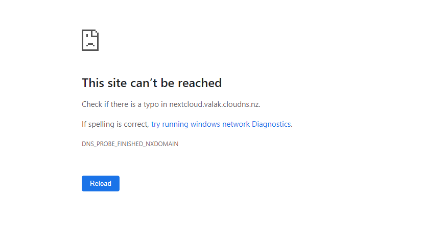

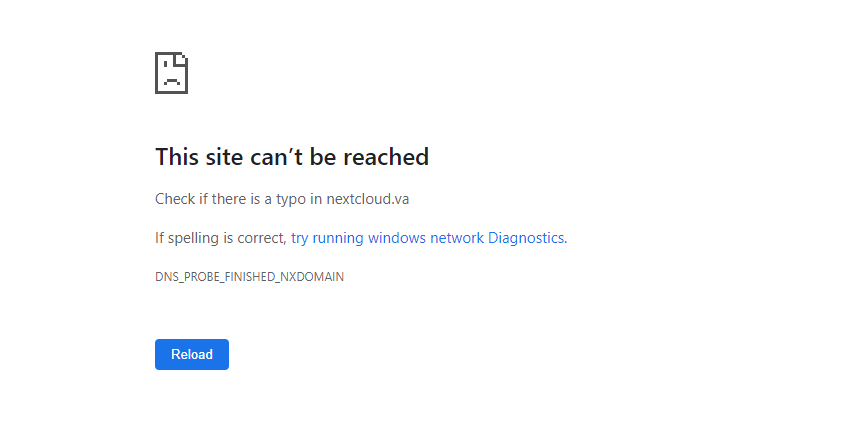

I followed the second video for setting up Ingress using a subdomain of nextcloud.va.net (Fake) my main domain of va.net for TrueNas GUI). After this I then tried access the NextCloud GUI via my subdomain but it fails with the following.
As per the video, I also edited my Windows Hosts file so that when I put in the IP 192.168.1.10, it would resolve to my Sub Domain. For an extra check I also tried access via 192.168.1.10:443, but will get an Error 404 page.

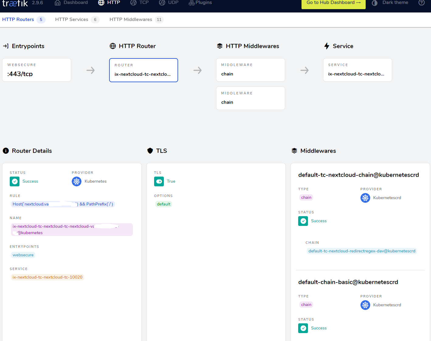

I also checked inside the Traefik app to see what was going on, I can see the below.
All "looks ok", but I am not experienced, so perhaps there is something telling here by those who know better.

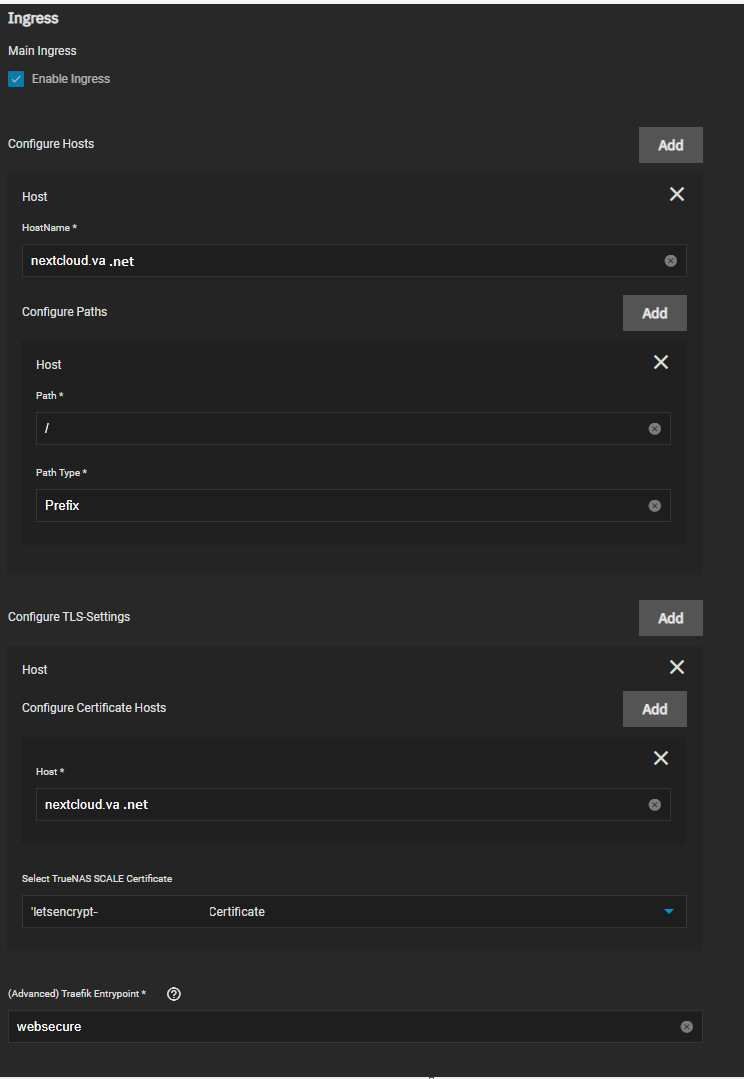

Just for reference my configuration that I set, as per the Ingress setup video is as below:
Did I miss anything ?
This sounds backward; you'd want the subdomain to resolve to 192.168.1.10. And really, you'd want to use some kind of DNS service for this, ideally on your router, or perhaps using Pi-Hole. But to test this, what happens if you run ping nextcloud.va.net from the command prompt on your Windows system?

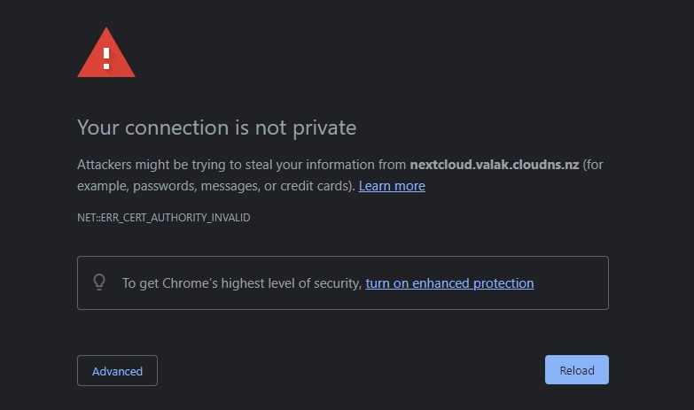

Regarding your other post. I managed to play with my DDNS settings, and browsing to the subdomain is now validating against DNS just fine, but even though my server has a valid and working SSL for my domain, and by extension my sub domain, I am getting an SSL error.
I will look into this video to see if that helps.
15,504
The Advanced button will give you more information about the problem, but it's likely one of two things:
  • You're using the default self-signed certificate, or
  • You're using a Let's Encrypt cert, but you requested it from the staging server.

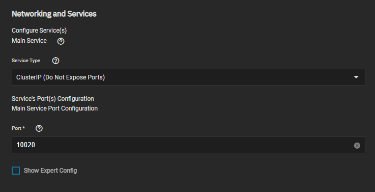

Update. As per the Last video suggestion. I went ahead and setup Cloudflare as an ACME provider and now I have a certificate on my TrueNas via LetsEncrypt., authenticated against Cloudflare, again, as per the video I also used a wildcard so that my sub domains for any apps should be fine. The Main Domain and Sub Domain are all working nicely with SSL as expected.
As per the video, I decided NOT to have a separate alias IP as suggested and went ahead and changed my TrueNas GUI Ports to 81/444 whiles configuring the Traefik app to use 80/443. Setting up the Alias was causing issues as the system would not allow me to add another Alias IP on the same IP Subnet and decided it might be better to just go the different ports method. I may try the IP method again at somepoint.
I decided to start fresh with NextCloud and re-installed it and set up the Ingress settings as before. However, if I use my sub domain, it will take me to my TrueNas GUI, instead of the NextCloud. I was also able to replicate this by going to the NextCloud App and clicking "open", it correctly loads the sub domain as per the ingress configuration, but will take me to the TrueNas GUI.
I am going to sleep on it, but wondered if anyone had any ideas on this one ?
