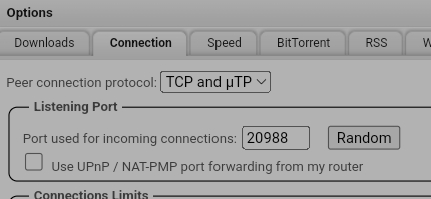

I have freshly installed TrueNAS SCALE in version 22.02.4 and I can't forward the connection port of the qBittorrent app (version 4.5.0_1.0.9). I have tried various configurations without success. I also have the Plex app which I have been able to forward its corresponding port without any issues.
Settings I've tried on qBittorrent:​
  • Options / Connection label:
    • Peer connection protocol: I've tried all options (TCP and µTP, TCP, µTP)
    • Fieldset Listening Port:
      • I've tried the default port: 6881 but also a random one: 45719
      • I've tried with the Use UPnP / NAT-PMP port forwarding from my router option checked and unchecked.

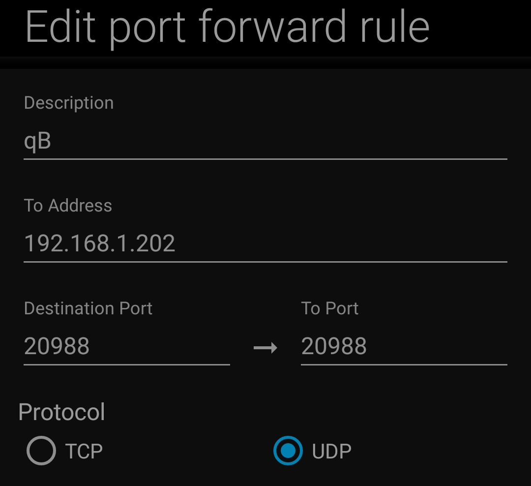

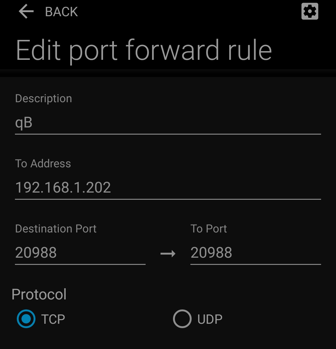

Router forwarding:​
  • Forwarding port 45719 (qBittorrent) to TrueNAS with IP 192.168.1.10:
  • Test made with qBittorrent ACTIVE and downloading a torrent:
  • Forwarding port 32400 (Plex) to TrueNAS with IP 192.168.1.10:
  • Test made with Plex ACTIVE:
I have noticed something that may be interesting... In the ports that qBittorrent theoretically uses, the one configured in the Options / Connection / Listening Port section does not appear. However, in Plex the port that I am redirecting does appear:

If you are using official chart qB, default TCP port are 20988.
You need change your qB port in webui to 20988 too.
If you wanna change it, you need change both two at same time
Pandorumx5
Feb 23, 2023
What do you mean by this? If I set the WebUI and TCP for the same it doesn't work, can't access WebUI.
