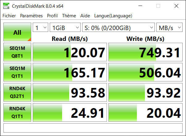

but reading speed are still king of 1GB limited (125MB/s shown by windows explorer dialog)

Well I got some weird values (smb copy is still r/w : 120MB / 600~300MB)

awasb
Jan 11, 2021
415
Thank you. The disks' "native" block size is 4096B and the pool's ashift=12 is correct (2^12). That's good.
Concerning your samba-output: The (usually quite interesting) global parameters are missing. Should be something like this:
Load smb config files from /usr/local/etc/smb4.conf
Loaded services file OK.
Server role: ROLE_STANDALONE
# Global parameters
[global]
        aio max threads = 2
        bind interfaces only = Yes
        disable spoolss = Yes
        dns proxy = No
        enable web service discovery = Yes
        kernel change notify = No
        load printers = No
        logging = file
        max log size = 5120
        registry shares = Yes
        restrict anonymous = 2
        server role = standalone server
        server string = TrueNAS Server
        unix extensions = No
        fruit:nfs_aces = No
        idmap config * : backend = tdb
        directory name cache size = 0
        dos filemode = Yes
As far as numbers are concerned, I'd wait, until the new disks are "in". :wink:

awasb
Jan 11, 2021
415
OK. No fancy multi channel / rss config. (Which hurts AFAIK when used with a spinning disk pool.) Again: good.
tngri
Jun 7, 2017
39
So that maybe related to the Chelsio NIC hardware or the cable ?
