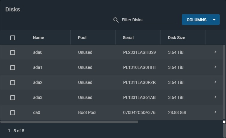

Does the system see all the disks? What do you see on the Storage -> Disks? If you don't see all the disks there, what's the output of camcontrol devlist? If the disks don't show there either, check your power and data connections. Samuel's right that if those two disks are dead, your data's toast, but we should establish that they are dead first.

@danb35 The system does see all the disks, the problem arises when I try and import the volume to a fresh install. One of the disks did get overwritten as a boot device on accident, but I do not recall a second one getting overwritten. camcontrol devlist also recognizes all the disks.
root@server:~ # camcontrol devlist
<Marvell Console 1.01>             at scbus9 target 0 lun 0 (pass0)
<HGST HDS5C4040ALE630 MPAOA580>    at scbus10 target 0 lun 0 (pass1,ada0)
<HGST HDS5C4040ALE630 MPAOA580>    at scbus11 target 0 lun 0 (pass2,ada1)
<HGST HDS5C4040ALE630 MPAOA580>    at scbus14 target 0 lun 0 (pass3,ada2)
<HGST HDS5C4040ALE630 MPAOA580>    at scbus15 target 0 lun 0 (pass4,ada3)
< Patriot Memory PMAP>             at scbus17 target 0 lun 0 (pass5,da0)
