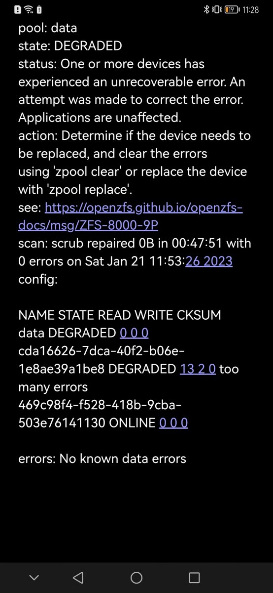

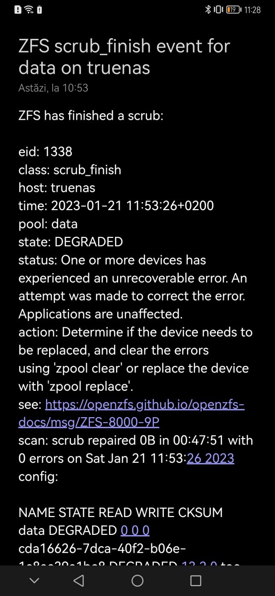

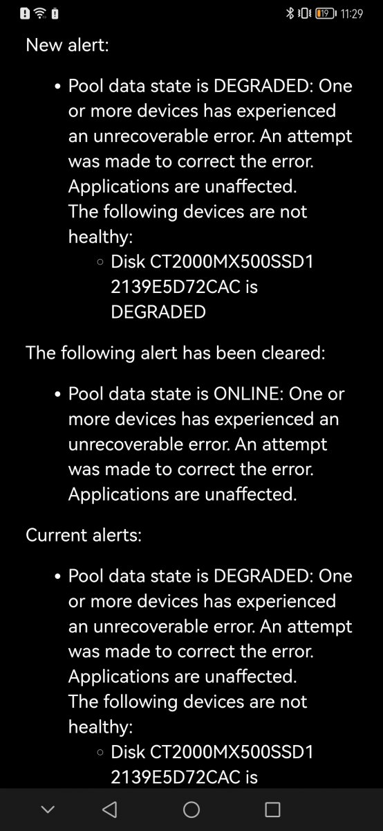

Hello all
I need some help to understand why one of my Crucial MX500 2Tb is starting to fail. Have only few months and around 6Tb writing on it.
Attached are also the smart results
Thank you

Thanks for answering.
Is heavy... My server is at 2000 km far away.
But on smart result the ssd appears ok or do you see some fails? Possible to be some data corruption?
The data on this server is not so important. If it fails doesn't matter. My question is why is creating this failure because I use same ssd's on other server where are important stuff.

On the ends looks like truenas is reporting completely wrong the failure of my ssd.
What should I do next to fix the degraded pool error?

sometimes drives just fail. this is why RAID(z) exists, to mitigate the known fact that drives just fail.
if ZFS reports a drive as returning bad data, smart is irelevant; the drive returns bad data. smart failures are merely one way to predict future drive failures, not the only way to know a drive is failing.
this can be caused by bad cables or other connections, or a bad storage controlller, and you will need to investigate all of these possibilities.

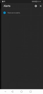

a scrub doesnt fix errors, it detects them. zfs will automatically fix any errors it can *if* there is redundancy.
you can zpool clear to clear the errors and see if more occur

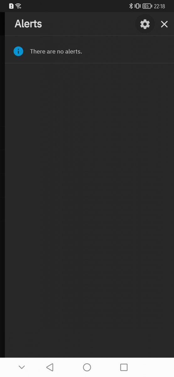

Error gone. Should I run new scrub?
Thank you very much for your advice
