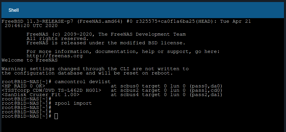

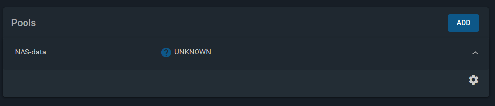

No idea what the 8GB dev is. Please see attached, for requested info.
Edit: and what's the 8GB device showing up as da1?

Jan 11 15:25:41 BiD-NAS ciss0: *** Temperature limit reached, Port: 1I, storage system 1
15,504
??? Why? It was working fine for months.
Right. Until it didn't any more. There's a reason they're universally discouraged with ZFS. See:
duketate
May 26, 2020
17
So, are you saying that there is no hope, or...???
15,504
There probably isn't any hope, unless you can recover the array using your RAID controller. However you've configured the array for those seven 2TB disks, your RAID controller is presenting itself to FreeNAS as a 228 GB single disk, so something's clearly gone very badly wrong. And the controller hides all the details from the OS, so FreeNAS has no way of seeing what's going on (and warning you about it, or potentially fixing it). And for some reason, your boot device is on your RAID controller--then you've got a USB stick there not doing anything that I can see.
Do you have any kind of configuration screen for the RAID controller? If this is going to be repairable, I'm thinking that's where it's going to need to happen.
