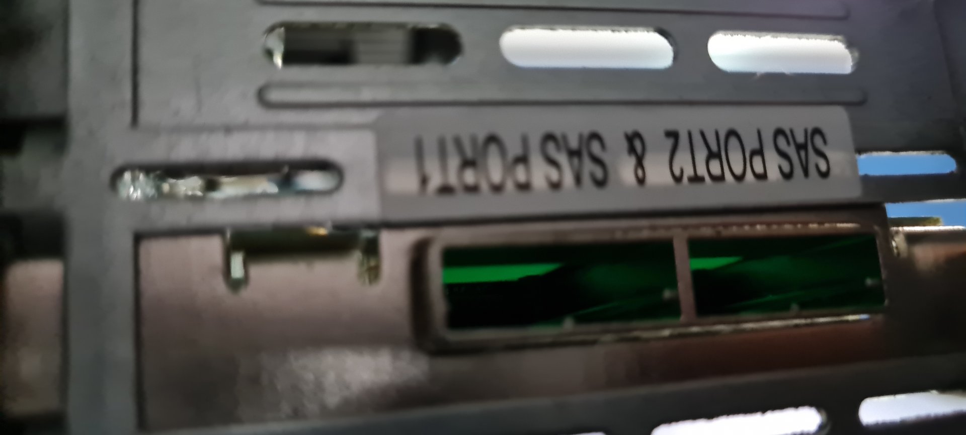

The system is/was a Netgear ReadyDATA 5200.

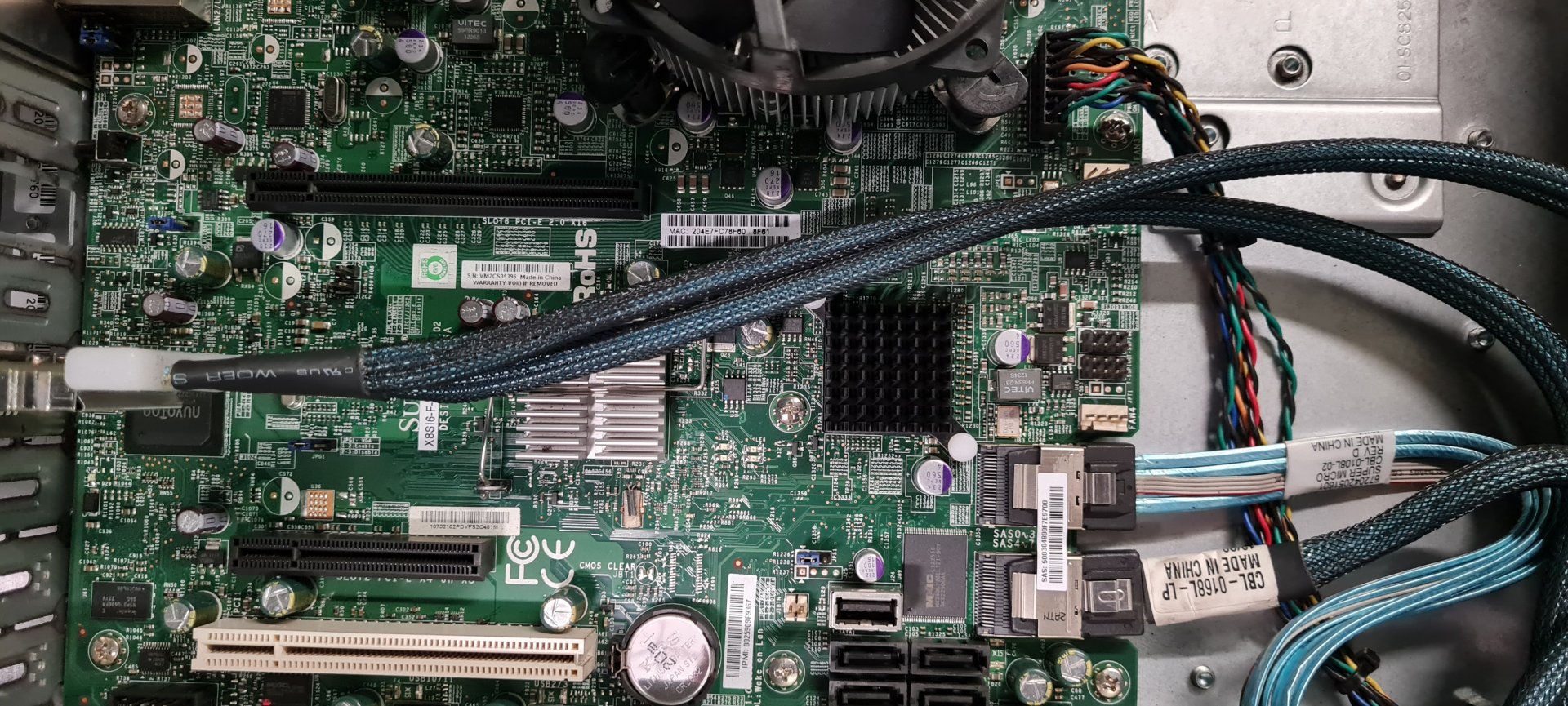

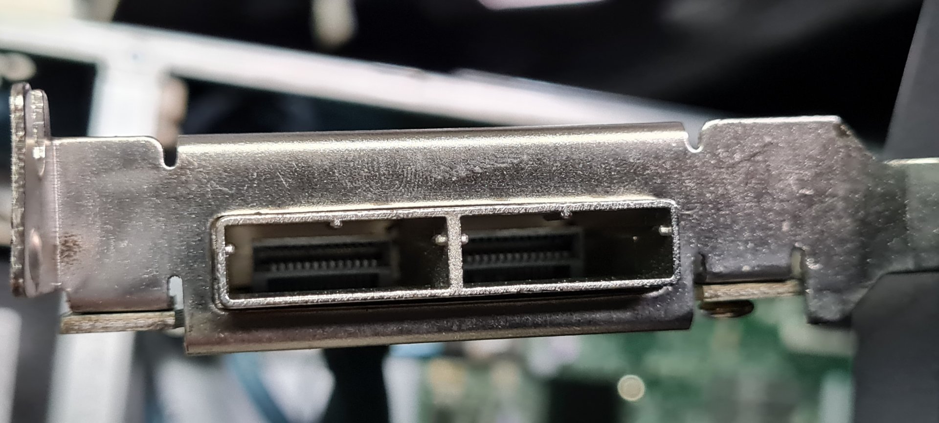

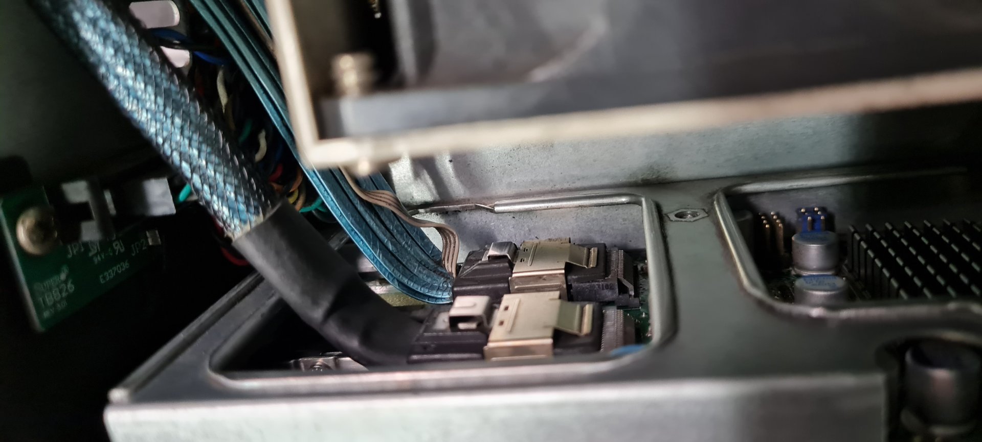

I took some pictures of the external SAS ports and internal cable connections:
From what I can see there are two different SAS ports/cables (only the thicker ones):
one connected to the HBA (for an external disk shelf I guess)
one connected directly to the backplane (to make the sytem act as a disk shelf I guess)

In documentation of Netgear ReadyDATA 5200 is stated that both external SAS ports are outputs for external disk shelfs.
Check again where exactly second cable is plugged - if it's possible make detail picture including labels of the card where the cable is connected. And one picture of the whole server internals.

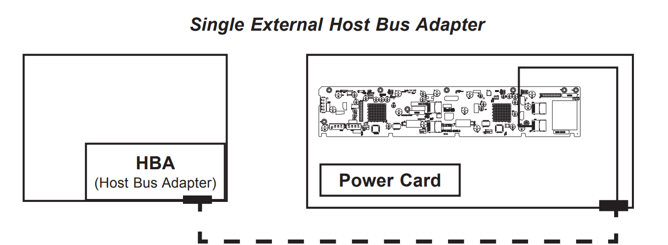

@nKk has beat me to the request. From the look of the hardware it's a Supermicro chassis, with an expander backplane - possibly a dual-expander - but it's likely the BPN-SAS2-826EL family.
There's a manual here in PDF format:
If so, it should be possible to rewire the SAS cables in order to make the Netgear behave like a disk shelf, by cabling as shown on page 3-7
I already took those pictures, you can see all the cables connected
The mobo is Supermicro and by the look of the chassis I also think it's a Supermicro one.
Monday I'll check the exact backplane model and took more pictures of it.
