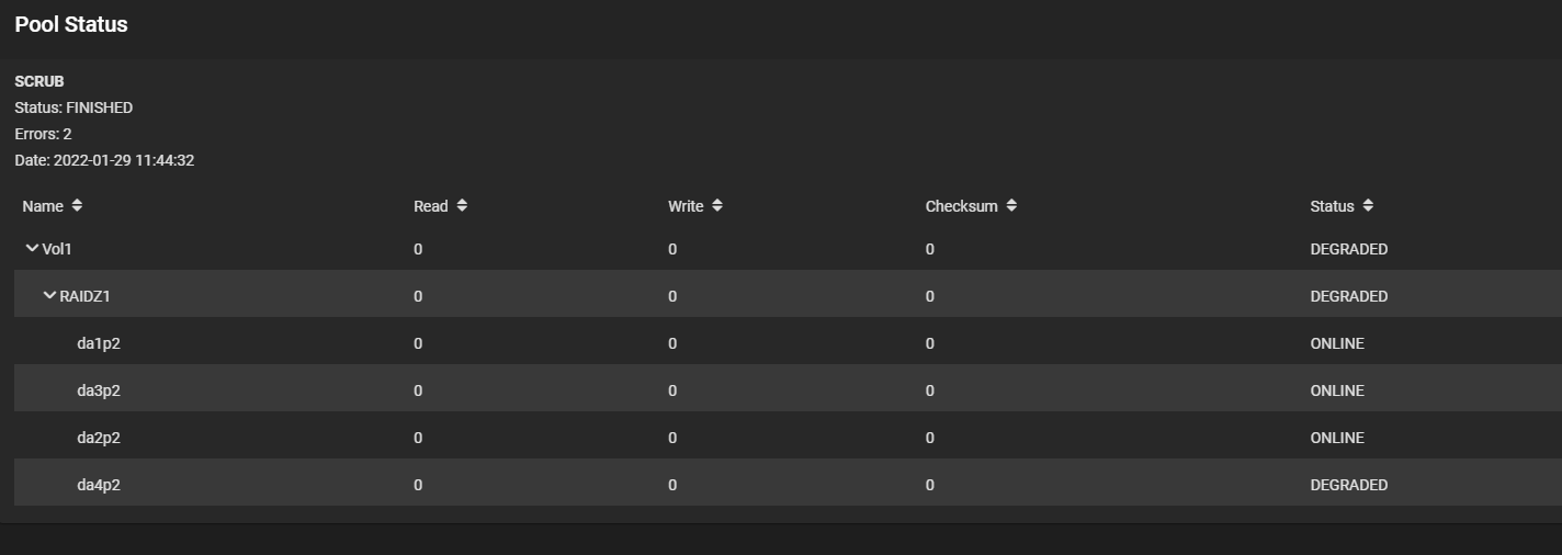

10 days ago the TrueNAS pool reported it was degraded and that Disk4 was the issue.
So I replaced Disk4 and waited 7 days for the resilvering to finish. Seemed rather a long time to me on Dell hardware.
Anyhow..... The resilver has completed and the pool is still showing degraded with Disk4.
Strange because I used HDDScan on my PC to check the disk first and it passed all tests.
Yesterday I did a short SMART test on all four disks and Disk1 failed but Disk 2, 3 & 4 passed. I ran a long test overnight and got the same results.
What should I do? Replace Disk4 again? or replace Disk1?
I have tried moving Disk4 to a different slot in the server and same results.

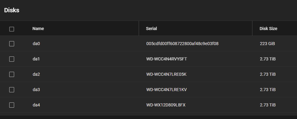

The GUI is showing disk4 degraded. see below
Editing disk4 shows the below serial number
That serial number matches the disk4 in the smart information. The smart information says no errors.
Editing the Disk1 shows the below serial number, which likewise matches the Smart information with errors.
Below is the Storage->Disk information
Any ideas???
