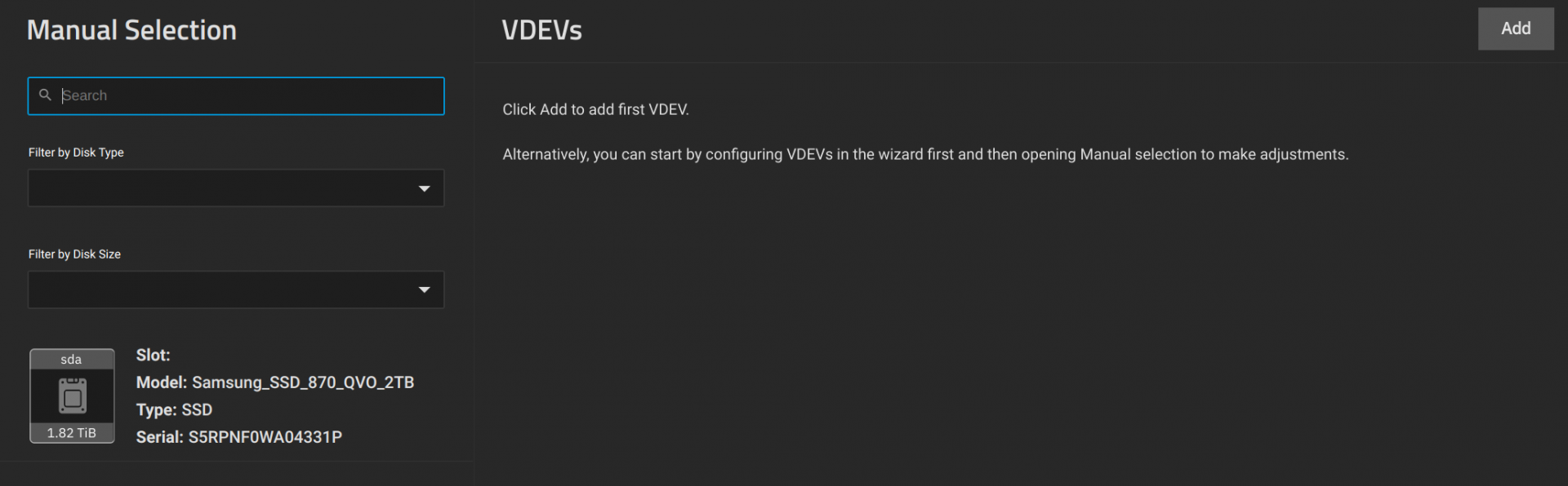

Hello everyone,
I'm a total beginner here. I experimented with Truenas Scale a bit in a VM and decided to install it on my GEEKOM A5 AMD Ryzen 7, 32GB RAM.
It has:
  • one 2TB SSD (Crucial P3 Plus M.2)
  • one 2TB Samsung 870 QVO SATA III.
As I did successfully in the VM tests, the plan was to have a 2TB mirror pool.
During the installation, I checked the Crucial 2TB SSD and left the Samsung unchecked.

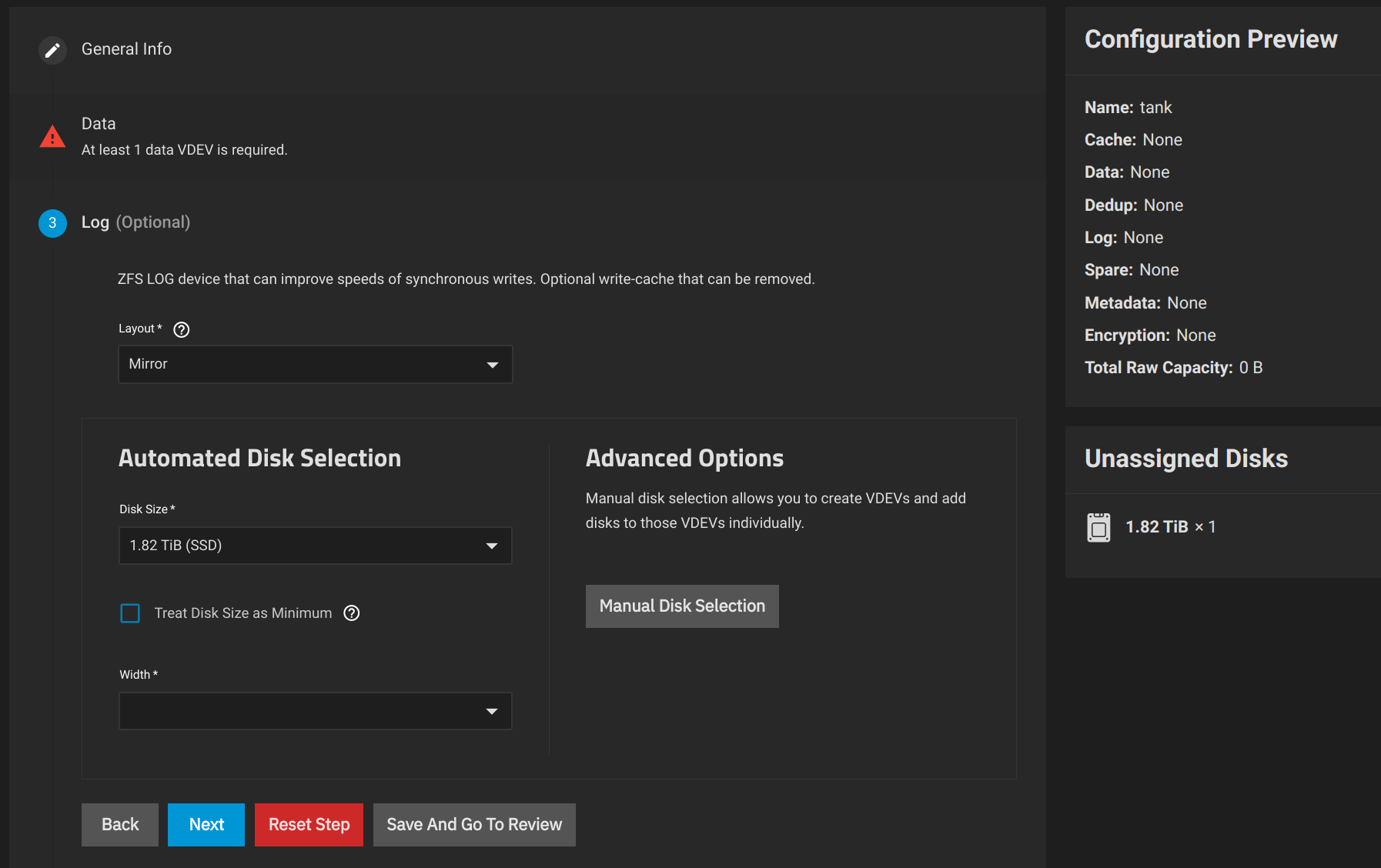

Now, when I want to create a pool, I have no idea what to do here. It won't let me continue due to the error: "At least 1 data VDEV is required".
Can you please help me set this up?
I really appreciate any help you can provide.

So you already have a pool with one of the SSDs in it?
Now you want to add the second SSD as a mirror to the first one? (but you're using the create a new pool option for that?... I guess this is where the problem is happening)
chuck32
Jan 14, 2023
623
Seems like @sretalla is right because no data Vdev is present, additionally your screen is for a log Vdev, not data Vdev.
To add a VDEV to a pool: Click Manage Devices on the Topology widget to open the Devices screen. Click Add VDEV on the Devices screen to open the Add Vdevs to Pool screen.

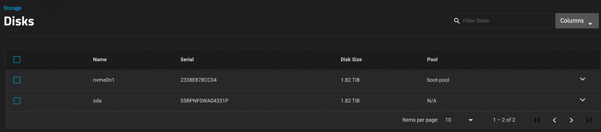

But I haven't created a pool. This is right after the installation.
Is it possible that TN used the first Crucial SSD as a "boot-pool" and now I can't use it for anything else?
What would be the solution?
9,703
Yes, that's what happened.
