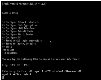

Ok so I tried to delete the original plugin/jail and start over. I installed the plugin, turned off VIMAGE, clicked save. Then I went to the jail and STOPPED it via the GUI. Finally, I clicked START. At that point, the "loading" pop up froze on the screen.
After about 10 minutes, I figured something was certainly wrong. I can no longer access my CIFS share, and I can no longer access the web portal. I tried a restart, but unfortunately it remains the same. I also tried SSH, no connection.
I do see FreeNAS booted properly though on restart (see attached). I know this because my motherboard shows me and lets me "virtually" connect from my PC as if I had a keyboard and monitor connected. See the attached image.
I'm not sure what happened when I started the jail, but it did not like it.
How can I get back to where I was before this jail? How can I get back into the GUI via the web interface, or even SSH?
