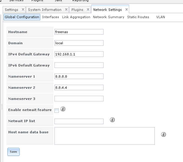

shackrock
Dec 21, 2011
95
Looks like I'm in the same boat... I've tried the same and no luck, including everything in that thread... see attached.
