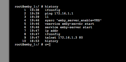

I managed to get them working. It I guess the plugins don't have their services enabled and started by default. Once I consoled into the jails and enabled the services they lit right up. Josh I do have a question though, what does VIMAGE do? I left it checked on 2 of the Jails but I don't really notice any difference in the operation from the other jails.
Thanks for all of your help!

you don't need to enable the services from the console. That's what the Plugins > Installed tab is for.
But.. glad you got it working regardless!
