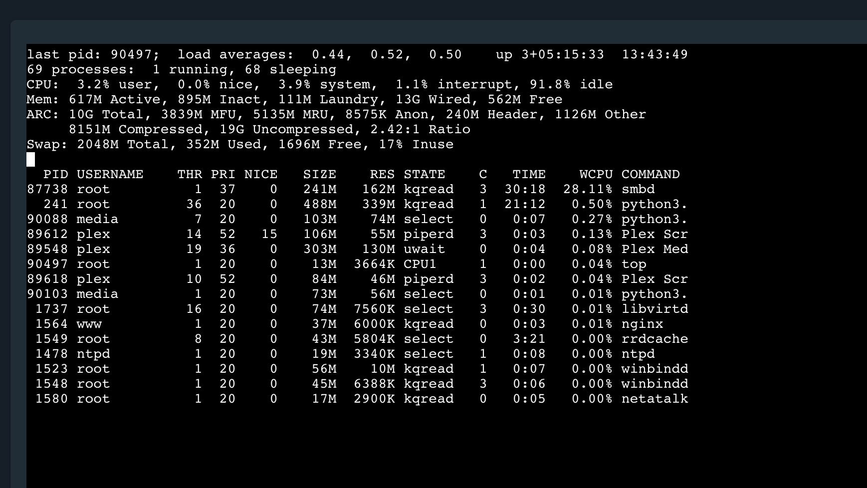

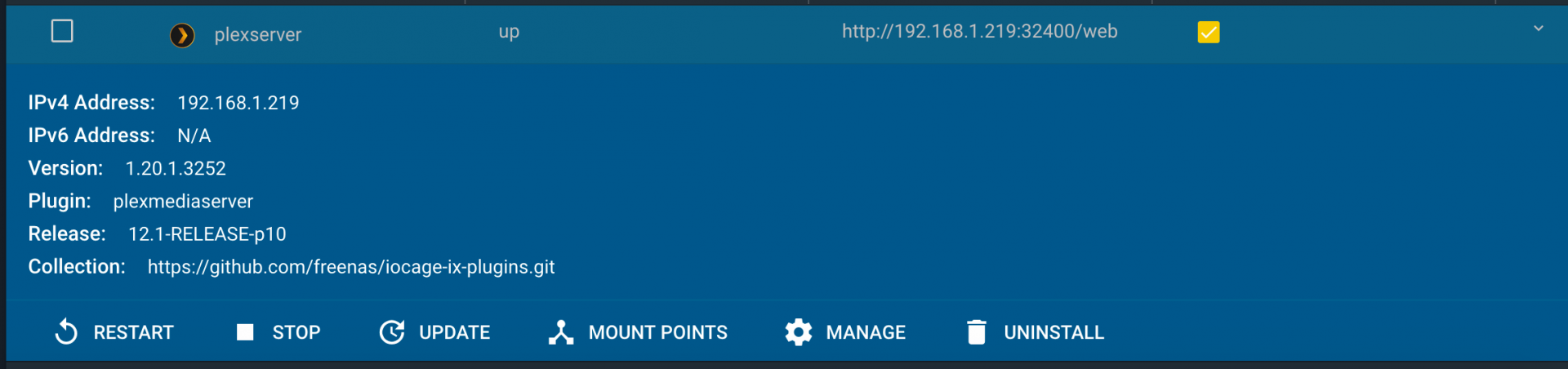

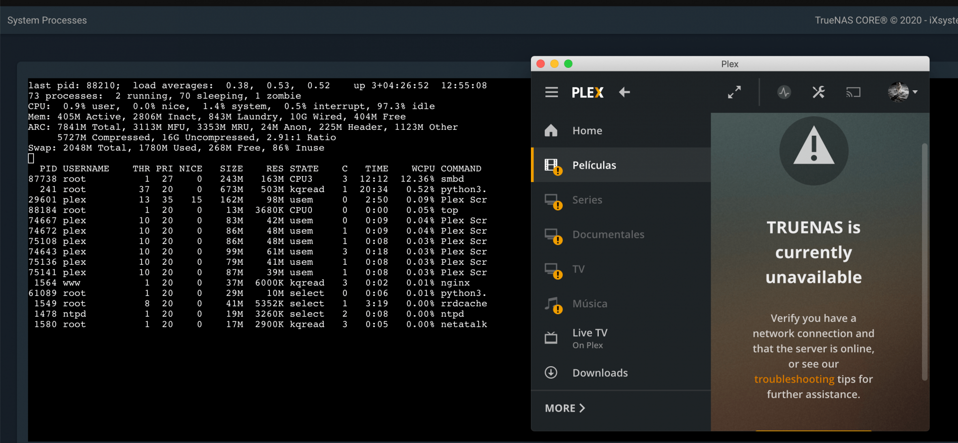

My SWAP is 2GB (default) and for example now that I am using PLEX and the VM (one person connected) of the SWAP only uses 352M, but if I have the VM and the PLEX (when crash) without working, the SWAP is 1780M . I attach both screenshots.

Something is happening causing you to use up all your RAM and forcing SWAP space to be used, and I wouldn't be surprised if you actually ran out of SWAP space as well, although I can't say that with 100% certainty. I can't explain why you would run out of RAM. I'd recommend that you turn off all of your jails and VMs, ensure FreeNAS runs without using any SWAP space (Used < 300M) and let it run for a while. If SWAP space stays at zero (it should be zero or close to zero if you have nothing extra running), then turn on Plex and see how it goes, look at the SWAP information again. If all is good then turn the next plugin and continue on until your find your SWAP space if being used. If you find something then turn off that plugin and ensure the SWAP returns to zero, this could take some time so a faster way would be to reboot the system.
If you identify the issue, I'd recommend reporting it as a bug if it warrants it.
