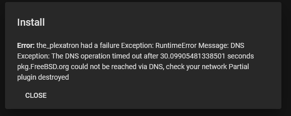

Hello,
I previously had a problem getting plex to read my files and solved that but the I had connection issues witrh plex where it wouldn't start so I uninstalled the plex plugin to reinstall it and just reconfigure it but now the plugin won't reinstall i just get this error message.
I would like to know what is the cause of this message since I am able to ping websites from the shell so I can access the internet with my nas.
-update i can't install any plugins

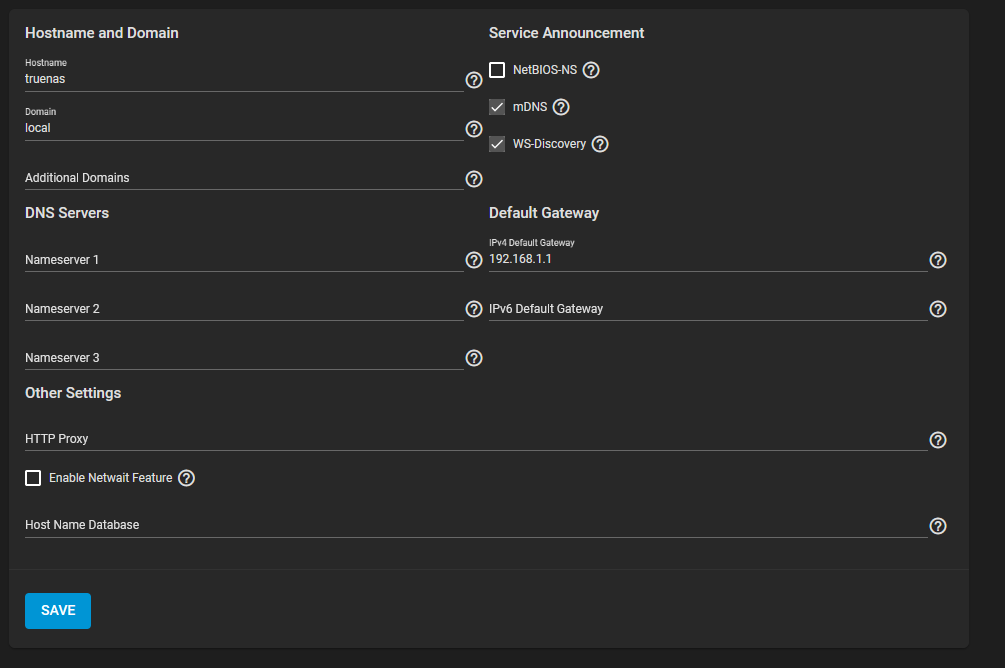

Under Network | Global Configuration make sure you have DNS and a Default Gateway properly set.

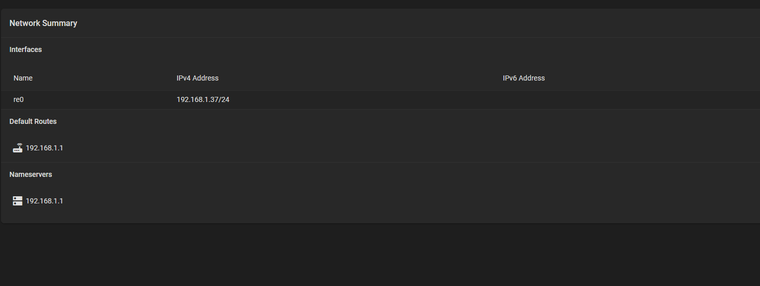

would the dns and default gateway in global configuration be my router because it won't work for some reason I have even tried to reset my network interface to the default settings and it still won't work, here are my settings on global config and my network summary
9,700
Default gateway looks fine, but if your nameserver on the router isn't doing the job, you can specify 1.1.1.1 or 8.8.8.8 in the configuration and see if that helps.

I added 8.8.8.8 to the dns list and it still won't work I get the same error.
