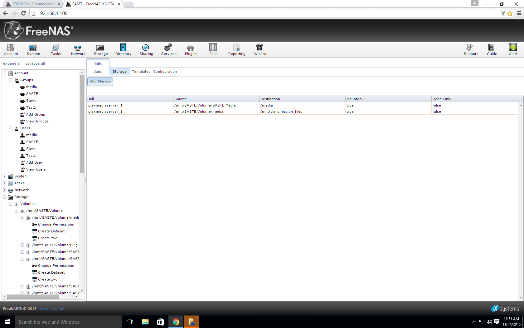

Can you show a screenshot of your Jails > Storage tab

Here is a screenshot. /mnt/SASTE.Volume/SASTE.Media is the plex's original data source, /mnt/SASTE.Volume/media is the one for Transmission etc...
Joshua Parker Ruehlig
Dec 5, 2011
5,949
there's nothing mounted to your transmission jai. i assume you want something mounted there's (like I describe in my blog post). you can then also mount that to your plex jail.

I totally missed that step...d'oh. everything else in the guide still worked, mkdir, etc.... so I didn't even realise I missed it.
I've added it, readded the folders, and got things started running. Not sure how many steps of the guide I'll have to redo now, but I'll work through it again.
Thanks for the help. (Changing to SOLVED)
