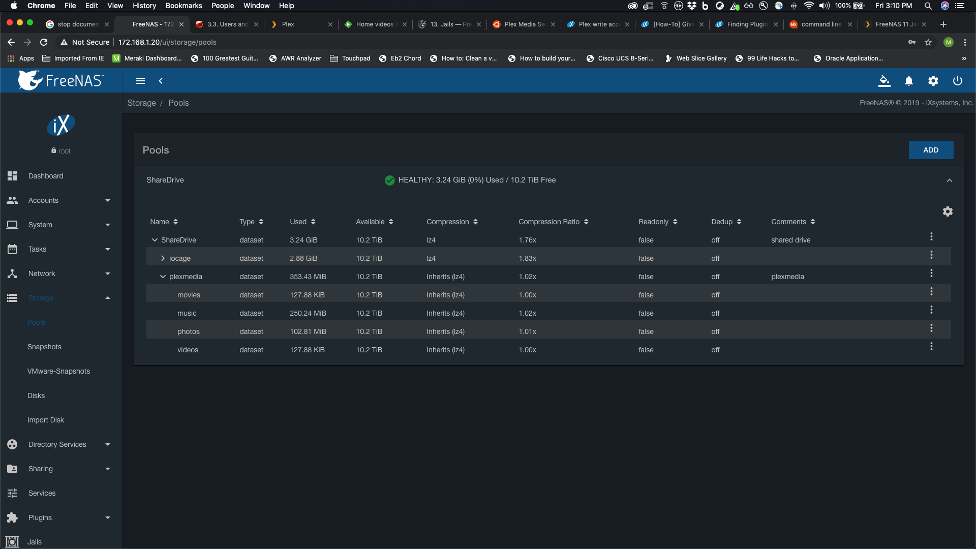

Are movies, pictures, tv, music and videos all datasets? You have to mount each dataset individually. All your permissions from your first post look correct. Permissions are not usually an issue with Plex because it just needs read.
15,504
Quoted for emphasis, and the problem was pretty obvious with the OP. OP, if you have datasets of plexmedia/music, plexmedia/movies, and plexmedia/photos, you need to create mountpoints for each of them in the jail. Otherwise you'll see exactly what you're seeing.
Like this?

I don't know those are just folders. Did you create a mount for each dataset in the jail settings
mcb14
May 8, 2019
11
BINGO! I figured it was something ultra simple. Didn't realize it needed separate mount points for each media. Thanks a million!
15,504
It doesn't. It needs separate mount points for each dataset.
