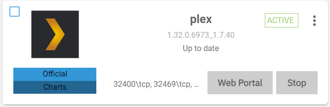

I had the same error yesterday and couldn't upgrade. But today it says that 1.32.0.6973_1.7.40 is up to date ... go figure ...
yes it's using GPU acceleration...
