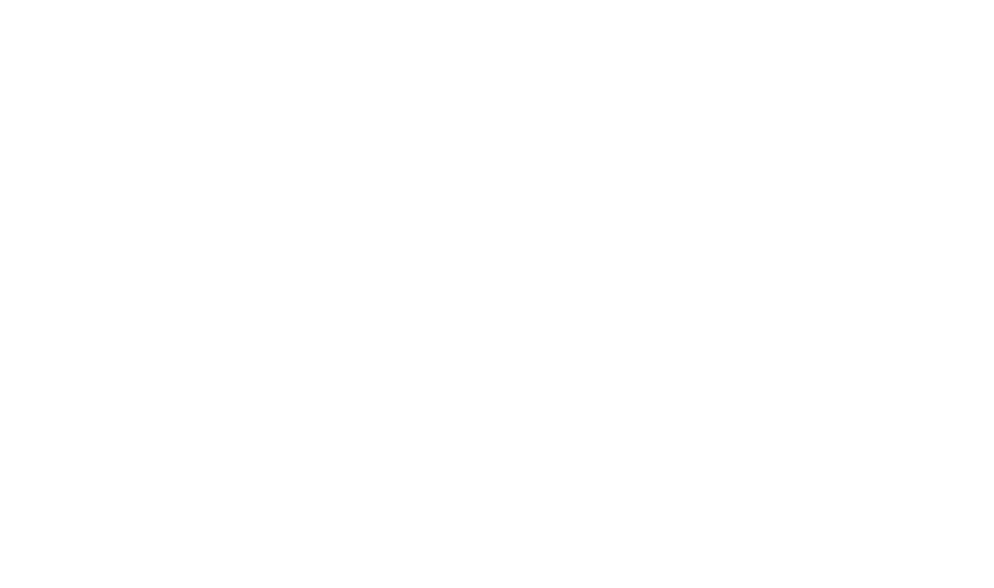

Mar 16, 2016
6
Hi
Often I get as a result the pressure of the "Update" button ("Aggiorna" in Italian), in the installed plugins section, obtain this irritating message: "manage.py: [middleware.exceptions: 37] [MiddlewareError: Failed to update plugins]" like described here as for the error number mismatch 38 instead of 37.
I tried to googoling several times in search for a solution, but no one is avail.
I tried reinstalling the Plex PlugIn and Transmission in different Jails and then to apply updates, sometimes it works and sometimes not.
The situation is almost unbearable.
Has anyone had experience with the string above, the middleware error, and if you somehow resolved?
Thanks for your attention
