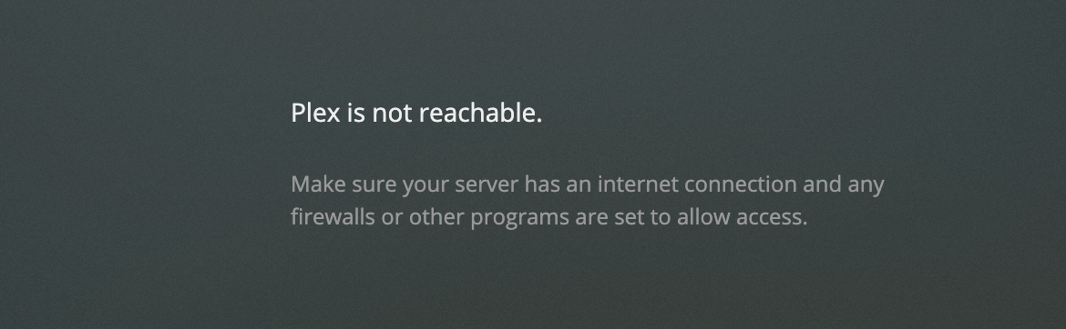

I tried to open Plex from the Chrome browser, loaded slowly, and ended up only showing one user option at the first screen. Odd since I have several.
After clicking that user to enter Plex, it gave me a not reachable error. However, I can ping google.com from within the Jail via ssh.
I haven't touched any settings for jails, plex, or my network in months. I tried restarting the jail, clearing browser cache, and jail stop/start. I also tried restarting FreeNAS server. No luck.
EDIT: This seems suspect. Found this in system.log: Requesting 'http://127.0.0.1:32400 Although static IP for jail is 192.168.1.202
Note:
  • I'm hardwired into my network.
  • Jail IP did not change.
  • Jail is up/running.
  • Mountpoints exist and media is intact on storage.
  • Shares are enabled and remain untouched.
  • I did a pkg update && pkg upgrade.

It's only Plex. All other jails working and connecting fine.
9,703
Plex (the service, not your jail) has a problem with their authentication service:
It's not you.

@sretalla Well shoot! I'll be damned...didn't even think to look there. Thanks.
thepixelgeek
Jan 21, 2016
271
LOL...This concluded our troubleshooting exercise drill, please return to your regular daily duties. @sretalla
